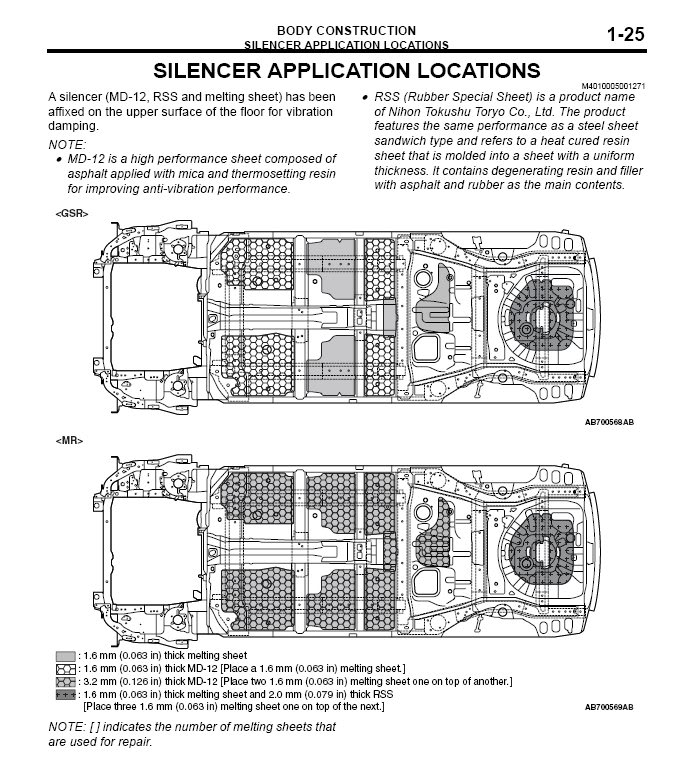

Does anyone have a MR stripped? I wanna see where the factory sound damping is located, because that is where i will put it, not lay it all over the entire cabin, which is a waste!
This is a great thought. Why put the sound deadening all over the place if you can strategically place it in a few places and get the desired result?
Has anyone driven a GSR and MR and can comment on how much quieter the MR is over the GSR?
+1 I've been wanting to know this too. The first Evo X I drove was an MR and that thing seemed super quiet; I could barely hear the exhaust. But that was back in July. I would expect that if the engineers were going to add another 11lbs. to the MR that it must be doing something.

The MR has more sound deading applied to it then the GSR. if you have access to the manuals you can find this in pdf "gr00000800-1.pdf on page 1-25. On average, it looks like the MR has twice the amount of MD-12 sound deading material applied to it than the GSR.
So to folks who are wondering if the MR is quieter... yup, it is =)
Thanks!
