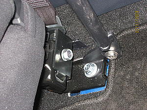

I installed the AMS Harness Bar over the weekend and what a great piece of equipment. It took me about 3 hours which included my time of trimming the B pillar covers for the upper bar mounts. I wanted a very clean hole which curved around the mount. I used a drexel to do the cutting.
The actual bar install took about 1 hour and the bar fit like a glove. It uses a stock thread on the B pillar for the upper mounts and new brackets for the lower mounting points off the stock seat rails. The bar is stout and has adjustability for the stock seats and aftermarket race seats. I'm 6' with long legs and the stock seat just rests on the harness bar. I like my seat further back than most so I don't see a clearance problem for anyone using the bar. Another nice design of this bar is still having full access to the rear seats. Again, I'm a taller guy and I have no problem getting in the rear or being comfortable once there.
I can't say more about the fit and finish of the bar, the welds, hardware and paint. The best part is the aluminum AMS logo in the center !
I'm building a NASA TT car and wanted 5 pt harnesses with 1 piece race seats. I wasn't sure about using the race seats for the street and wanted the ability to switch them out for the stock seat belts and stock seats. I thought long and hard about how to attach the harnesses while keeping the stock belts (and rear seats) in place and usable. This harness bar does just that and I couldn't be happier.
I'll go off the record and say the chassis feels stiffer to me. This bar and its mouting points are really solid so its got to help, although it would be hard to measure. It does built your confidence though.
Any wanting more pics of the install can email me.
Attached Thumbnails AMS Harness Bar Install-mods-022.jpg   AMS Harness Bar Install-mods-024.jpg
