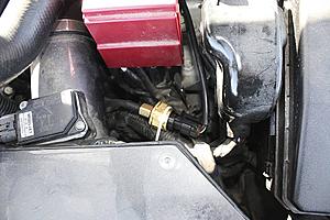

No, a pressure transducer sits in the engine bay. (See picture)
I ran the wiring harness for the transducer through the main firewall grommet, and to my gauge above the headunit.
It's very easy to keep it cleanly routed.
This might be the route I go, I thought you had to run VAC line through the firewall. Thanks very much for the picture.
