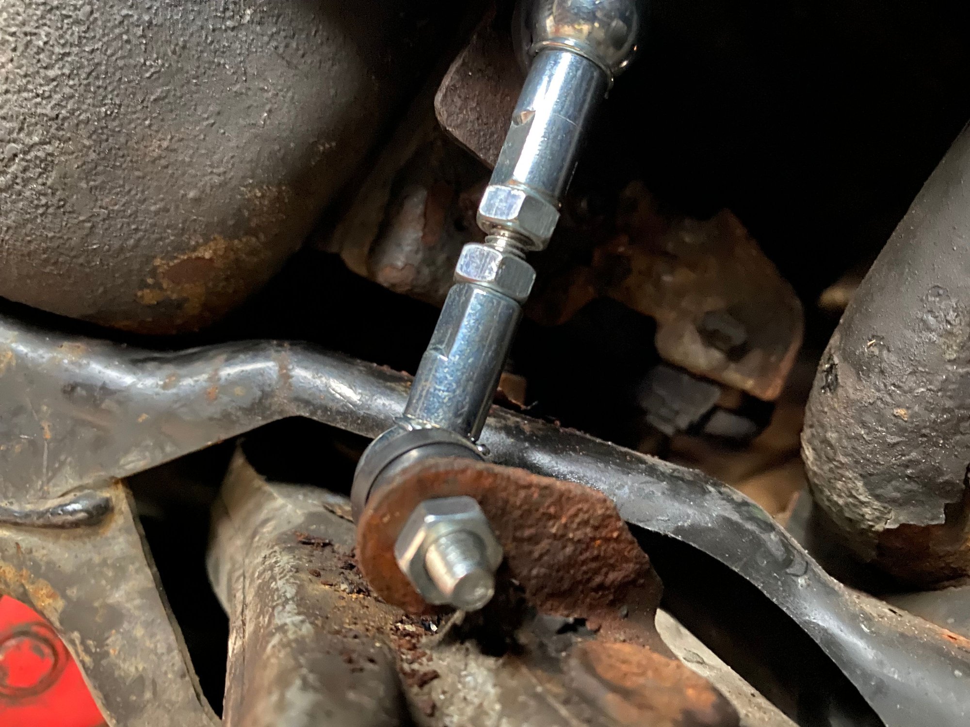

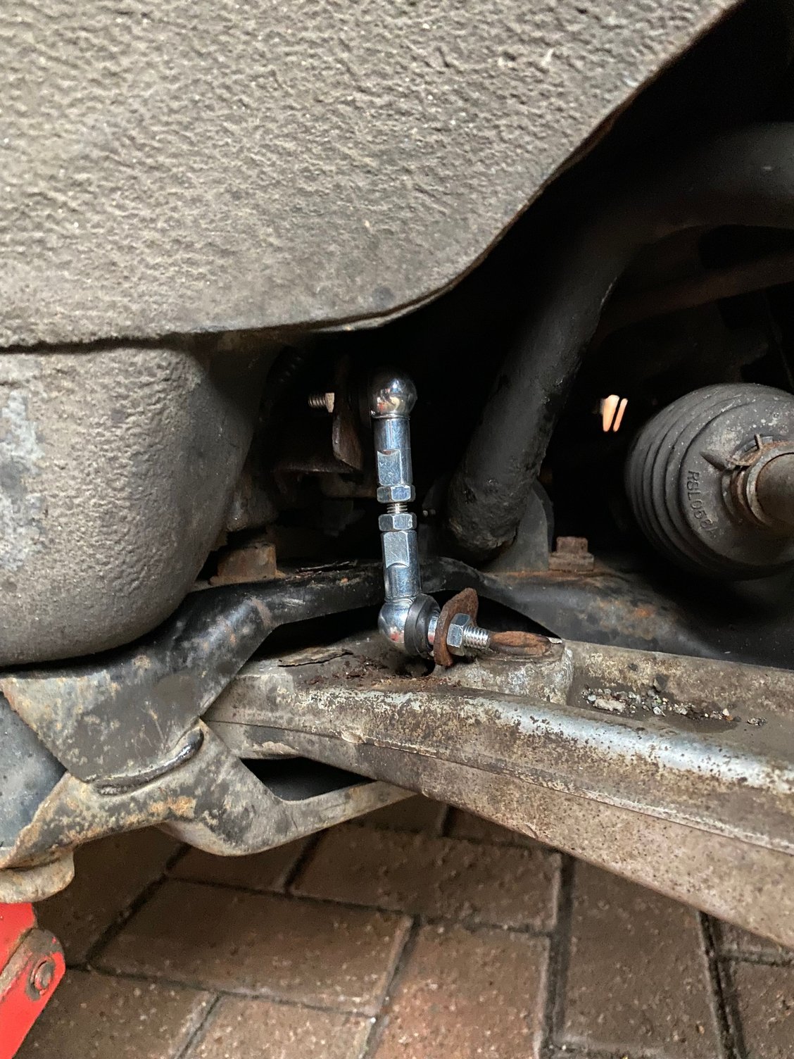

To adjust the hid headlights they are controlled by the suspension see pic
this is the bar that controls it I made this as my old one had snapped off
