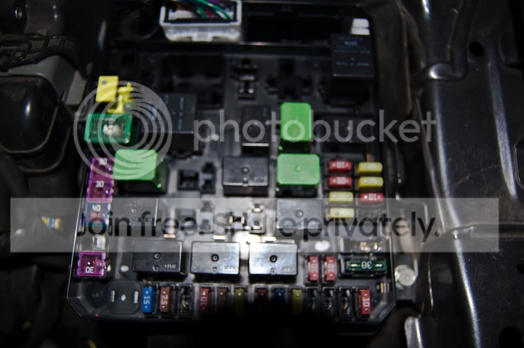

Fuel relay: I still have the black one! Could this be the problem? I swapped it with the high beam relay as seen in another thread here but still nothing. BTW, relay M works when placed in place of the high beam relay (G?... forgot).

You still need to change out that relay with the blue ones. And by the sounds of it your clutch is gone but the way your AFR is climbing in a pull is your car running lean which is common when running a black relay. Swap it for the blue....here's the link

One more thing, which really are we supposed to go with? Some say green and some say blue... which is it?

Blue!! Replace the relay and then drive it again and see what happens. Does sound like a clutch but you never know.

blue are the newest relays and SSP has a deal right now to get all new ones for a good price.
http://www.mitsubishiparts.net/catalog/?section=617
is this for the 2010 models also

yeah mitsu still hasn't fixed the problem. Everyone should be running the blue relay.

Change the relay, and test again. You can even swap the relay for the horn or really any other identical black one and see if it helps. $10 part is easy to replace.
