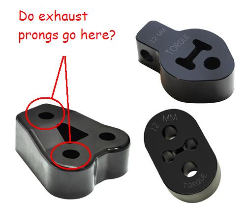

I recently bought torque solution exhaust mounts and they don't fit the AMS dual exhaust (I'm assuming stock as well). The biggest problem is the two rear exhaust mounts. I could only hang on one of the metal hangers in driver side rear mount in order to get it to fit. I also had to use a clamp to squeeze the metal hangers on the exhaust in order to get them to fit into the passenger side rear hanger. The exhaust hangs a bit lower at the muffler tip and isn't as flush. Anyone else have problem with torque solution exhaust mounts? It's bad enough that I am looking for some different exhaust hangers, anyone know of some good ones?

Okay, just to make sure I did it right. You put the two exhaust prongs in the two holes shown below?

Am I correct with the picture in my above post? Is that how you guys hung your exhaust?

I hung the rubber hanger on the car first before hanging the exhaust prongs. I had to get a clamp just to squeeze the prongs together, with quite a bit of force, in order to get them to fit in the two holes shown above. I was just wondering if it should of been the two holes diagonal to each other. See picture below, this is for the rear hangers only btw.

^bottom pic goes to the two hangers on the muffler

AHh that's what I figured, put them on the car before fitting them to the exhaust hangers. It's going to be a PITA to get them off. My set up is the first pic. I'm wondering if I should just cut the ones on there off and order some new ones haha.

No you had it right in the first picture I believe.

^I'm pretty sure the second pic is right. I've installed alot of X exhausts in the past few years.
OP, you can just take some wd40 and a pry bar to remove the rubber hanger. I wouldn't waste money and buy new ones.
