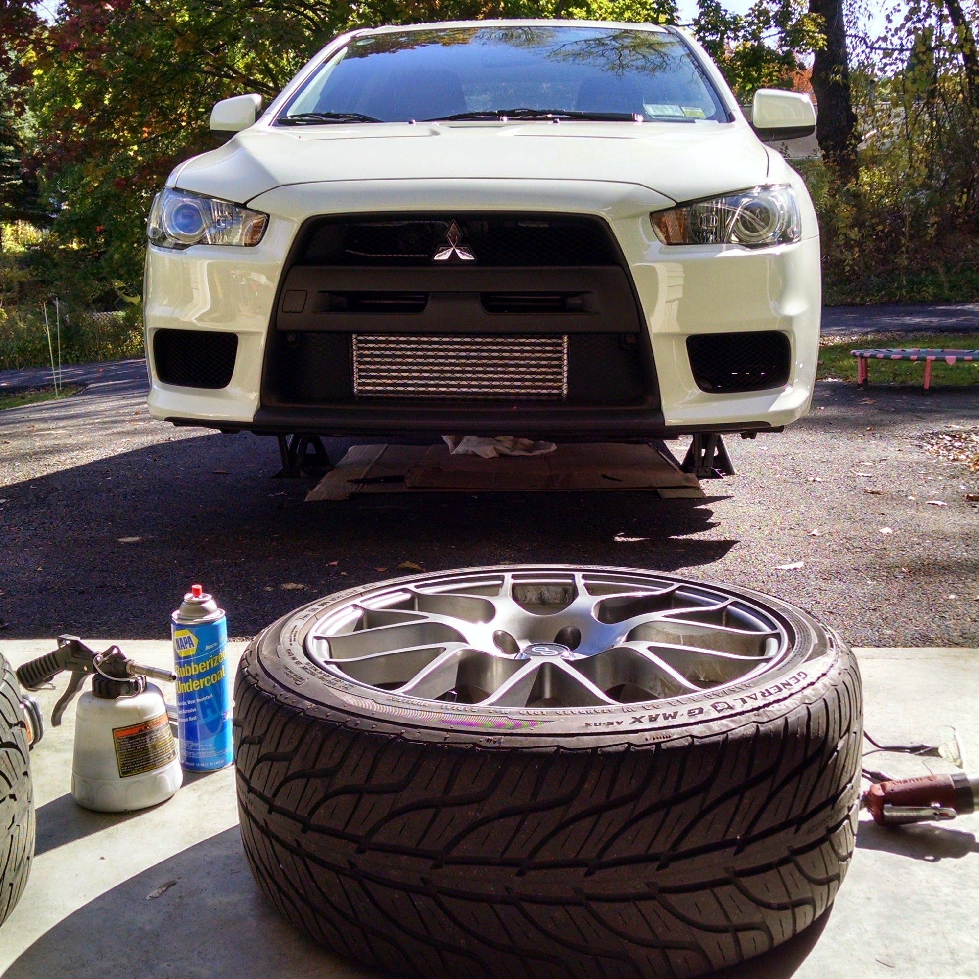

So I bought two new cars new in 2012. A KIA Sportage and Evo X MR. After owning them for a month or two I decided to be proactive and do my own rust proofing. The KIA had better factory rubber undercoating than the Evo! Not the material being better, just that they did MORE of it. I finished what the factory started on both cars using NAPA rubberized undercoat spray (rattle can). Use the correct gas mask. I will say that again: use the correct gas mask! This stuff is nasty. When it dries, you cannot tell it apart from the factory rubber rust proofing stuff. Fast forward 2 more NY winters. I inspect the undercarriage of the Evo X and find rust at nearly all weld joints of the supporting subframes and other areas like the jack points, and bumper area. So any rust I can spot I bead blast to bare metal and coat with POR-15. This is now my go forward plan every other year. Inspect - blast away rust, coat in POR-15. The areas that I have done show zero signs of rust coming back. You have to get to bare metal. I believe that if I keep inspecting, removing, coating that I will keep this evo alive and well. Looking under it right now you would think it was Texas car !
The blue can is NAPA rubberized undercoat and the bottle next to it is the bead blaster.

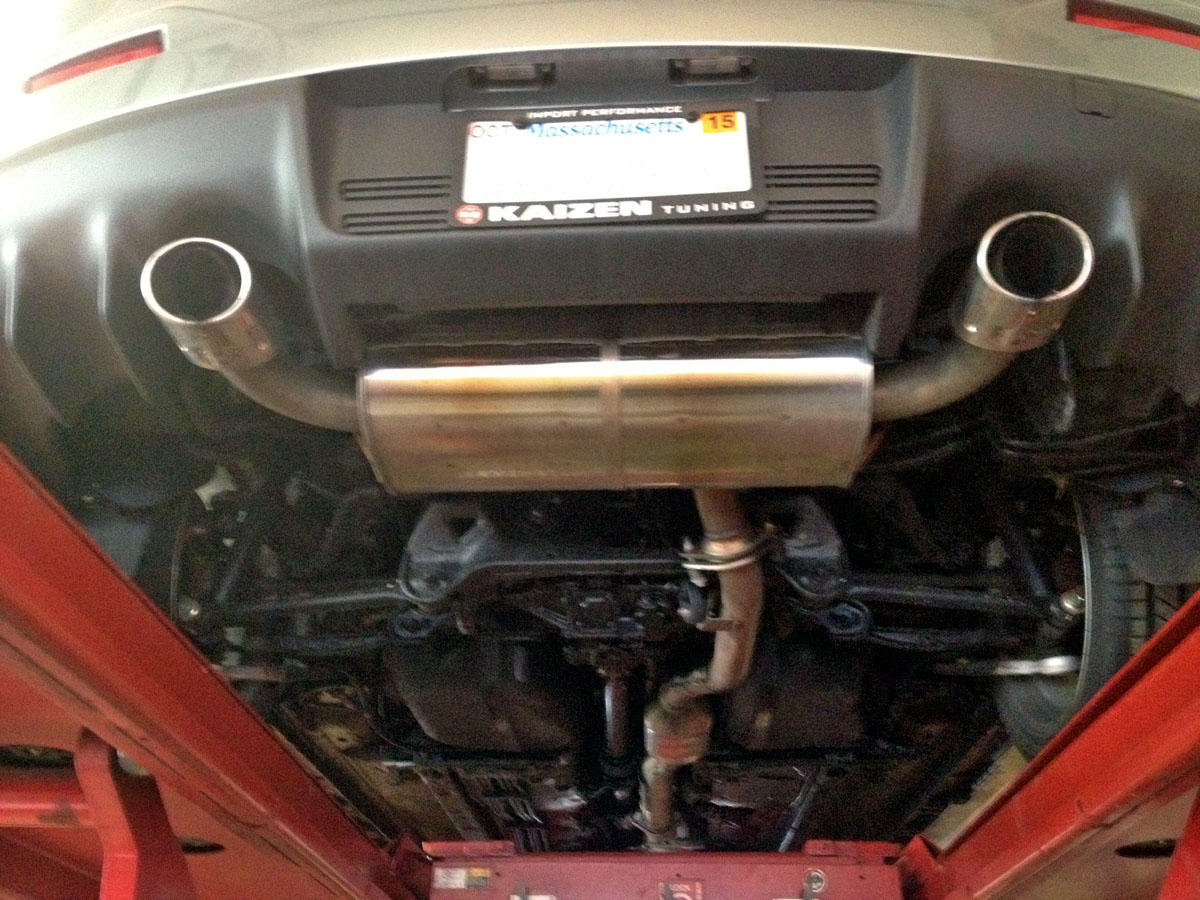

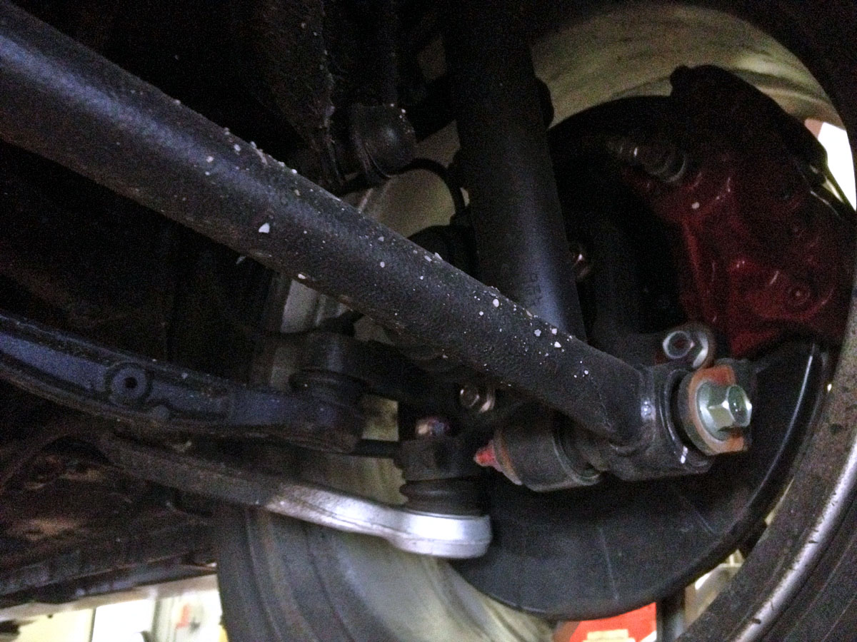

Originally Posted by khmerguyx
That's where I got mine done. The quality of their undercoating is quite impressive and I have no complains.
