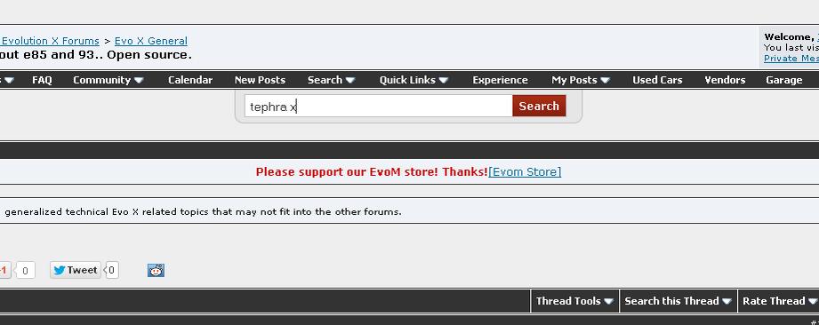

Originally Posted by GsrJake
Ok thanks, may I ask what the tephra X is? Ive never heard of it lol
You've got some reading to do, dude.
