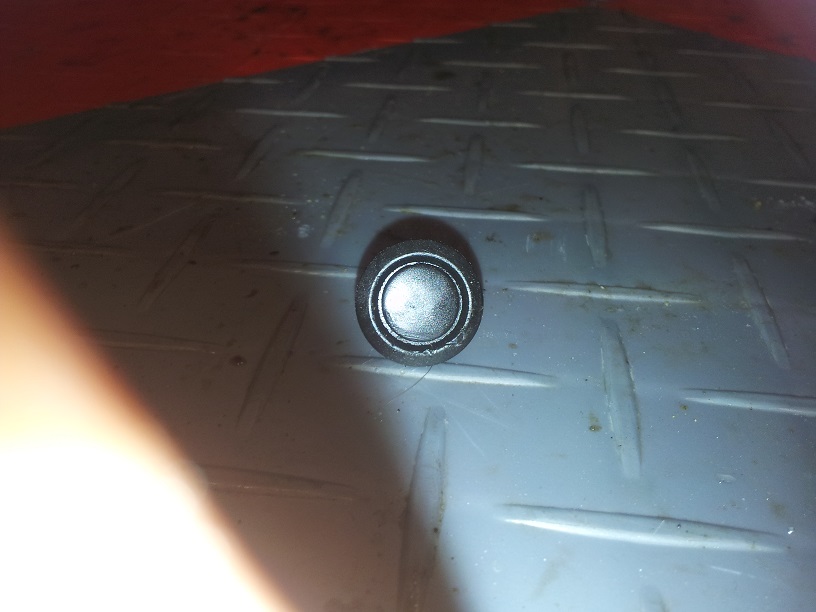

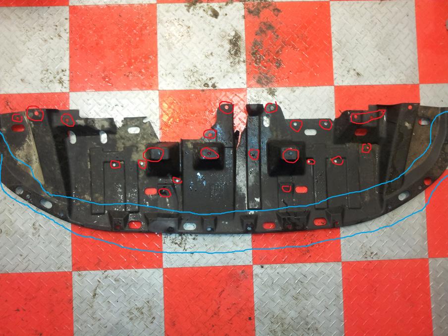

The front plastic underbody plastic protector was sagging real bad so I removed it. It seems that a lot of clips fell out, pretty much all of them besides the ones at the front perimeter of the covers(s). I guess it got caught in the snow and compounded the problem and pulled more of them off. You can see that the back got chewed up. I never inpected this piece closely before so I m not sure what *type* of clips I'm missing, and which ones I *actually* need.
The part circled in blue is the part I have bolts/clips for (the ones that still remained on the vehicle)
I circled in red where I think I need clips (pretty much anywhere there is a hole)

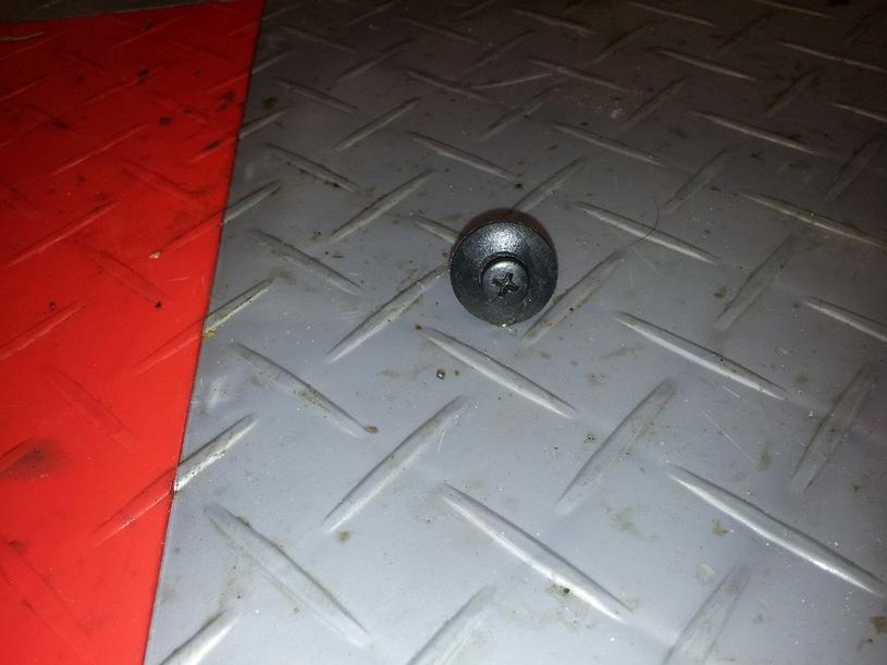

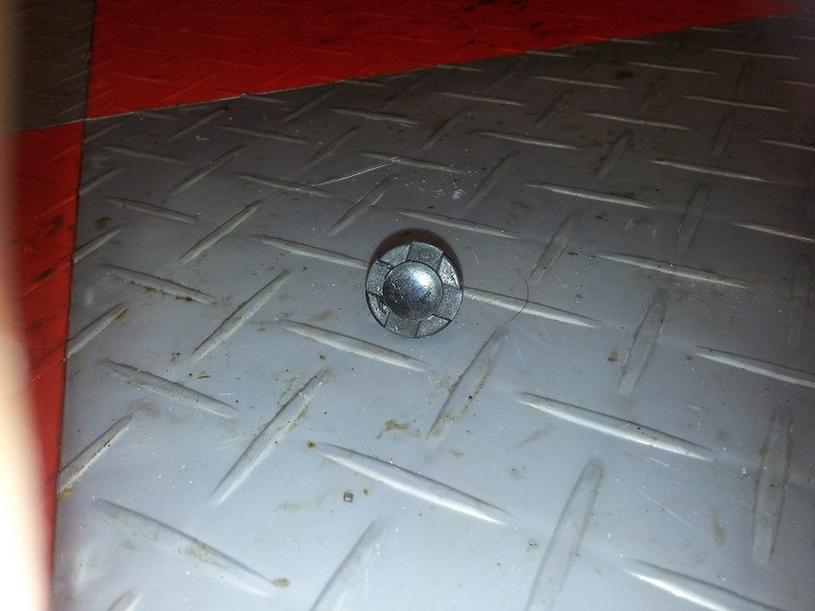

I have also attached pics of the different clip that still where on the vehicle. I requesting your help to identify how many each I need to order and where they go

i believe everything you circled in red is the same clip. (what you have pictured in attachment #1).
i don't recall anything like picture #3 on my car.
as far as what you have circled in blue, the 5 front center most holes are 10mm headed bolts on my car. (the same as what attaches the oil service access panel)
then the 3 immediately on either side of these bolts are the round ones (your 2nd picture).
the remainder of the holes (cut off in picture #2) again are the clip in picture #1.

All the ones in red would be your first clip pic.
