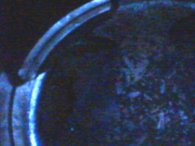

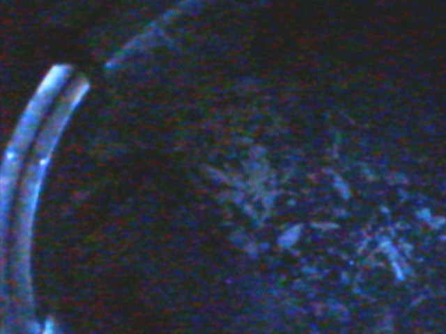

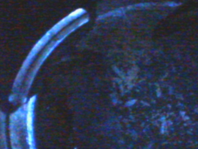

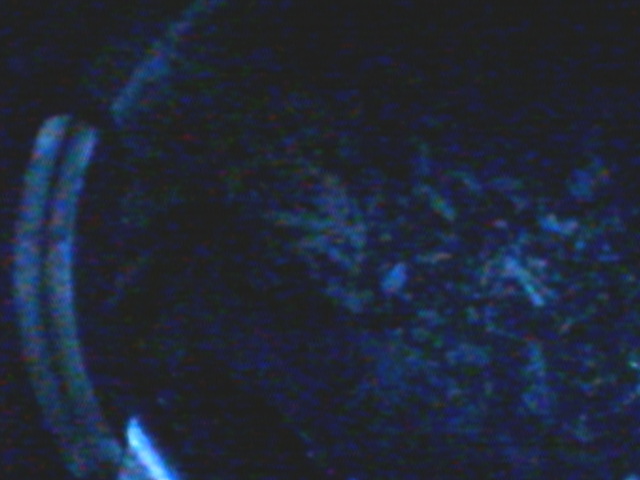

While driving home from work last night around midnight no traffic on i20 inter state highway i decided to stretch the legs on the car a bit. was cruising in 5th gear around 65mph, then down shifted to 3rd and went wot and speed pick up pretty fast, but when i was around 85mph almost top of 3rd gear and rpm around 7300 i looked at my Cobb accesport and it registered 12+ knocks very fast, so i cut off on the gas pedal and limped very slowly back home, wasn't but 3 miles from the house when it happened. AFR was at a steady 12.0afr when i was at wot. When i stopped on a stop light the car was sputtering and idling badly. Got home let the car cool off for 4 hours, then i started checking under the hood. Checked vacuum lines, intercooler piping, fpr hose, FP relay everything was OK, I left the spark plugs for last and behold what i found. the culprit was the closest spark plug to the throttle body or for other reference the drivers side. I did not checked the spark plug gap when i put them in new, i guess i should of have, but i didn't have any issues before. Any feedback would be greatly appreciated. thanks.

My fear has been confirmed. Chipped piston, pretty good size as well. Compression 110,120,120, Chipped piston at 100. Will upload pictures later. Sad thing I baby my car, never launched, and hardly ever punch it.

It wasn't the piston coming up higher. It was the broken piston piece hitting the spark plug. If the piston it self came up that high, it would have hit the valves way before hitting the spark plug.

pictures
Attached Thumbnails Spark Plug Failure. HELP!-digi0013.jpg   Spark Plug Failure. HELP!-digi0014.jpg   Spark Plug Failure. HELP!-digi0019.jpg   Spark Plug Failure. HELP!-digi0020.jpg

Ok gotcha, piston broke and a piece hit the spark plug. I was thinking piston hit the spark plug, breaking a piece off the piston. That makes more sense.
Next question is, any idea why the piston broke...?
