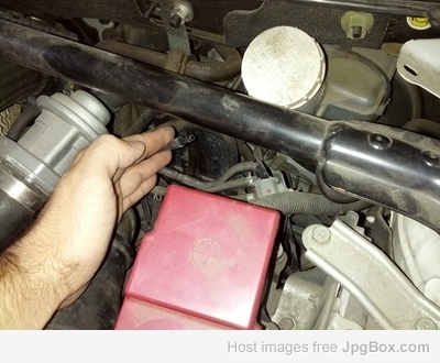

Hello.
Was this small hose supposed to be plugged anywhere ?
It is on driver side behind the + terminal. In the picture i bent it to see the end, it was pointing towards the engine.
Thanks.

It goes to a hole in the intake snorkle (i.e., the large, accordion-like tube that feeds air to the turbo).

Mine was disconnected too when I got the car....mitsu kinda failed on clamping hoses down on these cars

Thanks. I will check, on a first look yesterday I didn't find a hole for it.

Hoses that only see vacuum don't really need clamps. But the OP should definitely take a look at the hose from the intake manifold to the fuel-pressure regulator. https://www.evolutionm.net/forums/ev...s-do-asap.html

@Iowa999 I seen that post before and I think I checked it, it was not very tight but still in place, I will look again and secure that one with zip ties.
