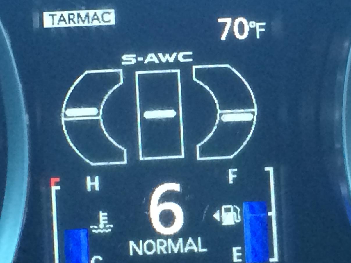

Recently purchased my Evo X and looking to see if someone could give me some insight. On the S AWC cluster that indicates your G's or yaw movement anytime I am above 50-60 mph it's always indicating. I will be in no turn just driving straight down the freeway and it will indicate. I have asked and I know it should not always indicate like this, anyone have any idea what might cause this Alignment issue, unbalanced tires, I've also heard people mention steering angle sensor??? Any help would be greatly appreciated.
Thanks, Andre
I've attached a picture of the indication driving straight at about 65 MPH.

Yep. If the display is indicating that the AYC is active even when you're going straight ahead, it has to one of two things: (1) your steering-angle sensor is shot (or, at least, the ACD/AYC ECU is being sent a bad reading) or (2) your steering wheel is actually turned.
Note that some people fail to mark the steering wheel when they remove it and then put it back on crooked, not knowing how important this is to a car like ours. But it was marked at the factory. If you disconnect the battery and pull off the airbag, you can see if the steering wheel was reinstalled turned. And please note the bit about disconnecting the battery.

You're correct that it doesn't matter which way the steering wheel, itself, is angled. What matters is that the column (on which the angle sensor sits) is centered relative to the wheels and tires. But, because most alignment techs are taught to center the steering wheel and then set toe, if you don't keep the steering wheel centered on the column, the next alignment will lead to an AYC issue. Plus, it seems to really bother people when the steering wheel isn't straight when driving straight.

No, the wheel is centered as I'm driving. Over some bumps I could understand, that would make sense. This is almost all the time as soon as I'm over about 50 MPH and it stays until I slow down...

And it's the AYC indicator, not the ACD?

Wanted to thank everyone for their input. I was hesitant to to the X to the dealer at the time because I was in the process of getting my wheels powder coated and tires replaced. Long story short got wheels back and new Cooper RS3's and the issue is gone! Def don't think it was low tire pressure because I never had a light. Possibly unbalanced tires or maybe even the fact that there were mis matched tires from when I purchased it. Once again thanks for all the input/suggestions and hopefully this can help someone down the line!
