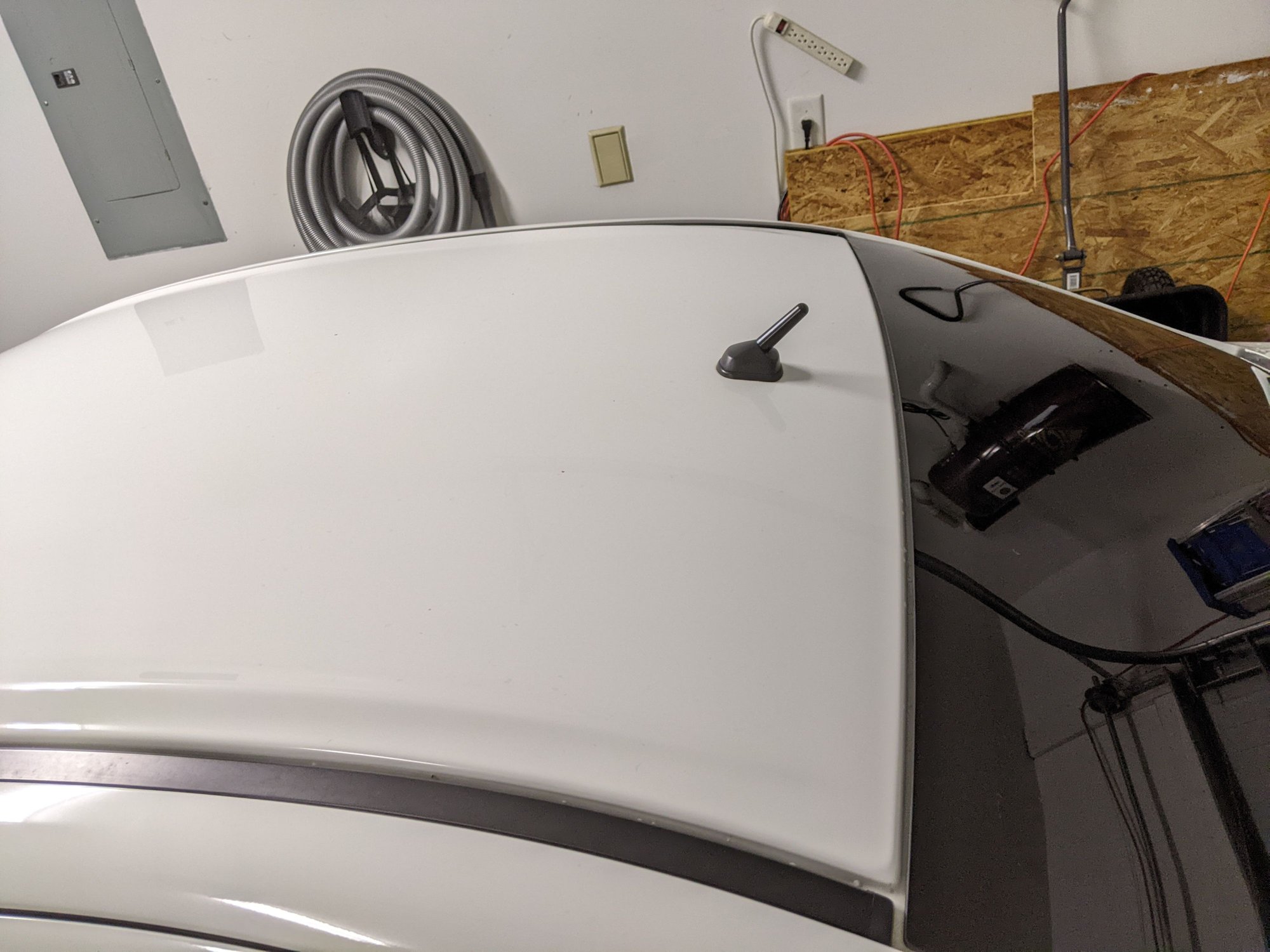

I'm trying to figure out my roof. Since MAP has multi-vortex parts.
I did email MAP with the question What's the difference between "Rexpeed Non SSS Painted Vortex Generator | 2008-2015 Mitsubishi Evo X" & "Rexpeed Flat Roof Painted Vortex Generators | 2008-2015 Mitsubishi Evo X
"Hello there,
So you have the SSS roofs, The non SSS roofs and the Flat roofs. The NON sss roofs have some bumps and are not totally flat. So you want to go with the non sss one as you are not a flat roof car. You have the two humps on the side of your roof and your antenna should be 5x6 I believe if your not SSS. "
Isn't SSS Sun Sight And Sound. Car never came with sub in the trunk if it did it was taken out, and the car had an after market android radio. And I sure don't have a sunroof as you can see lol
I'm just a tad lost.
