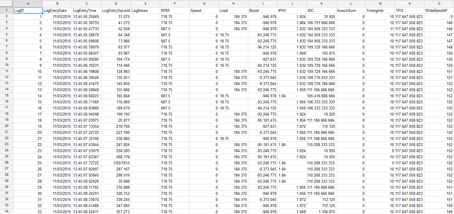

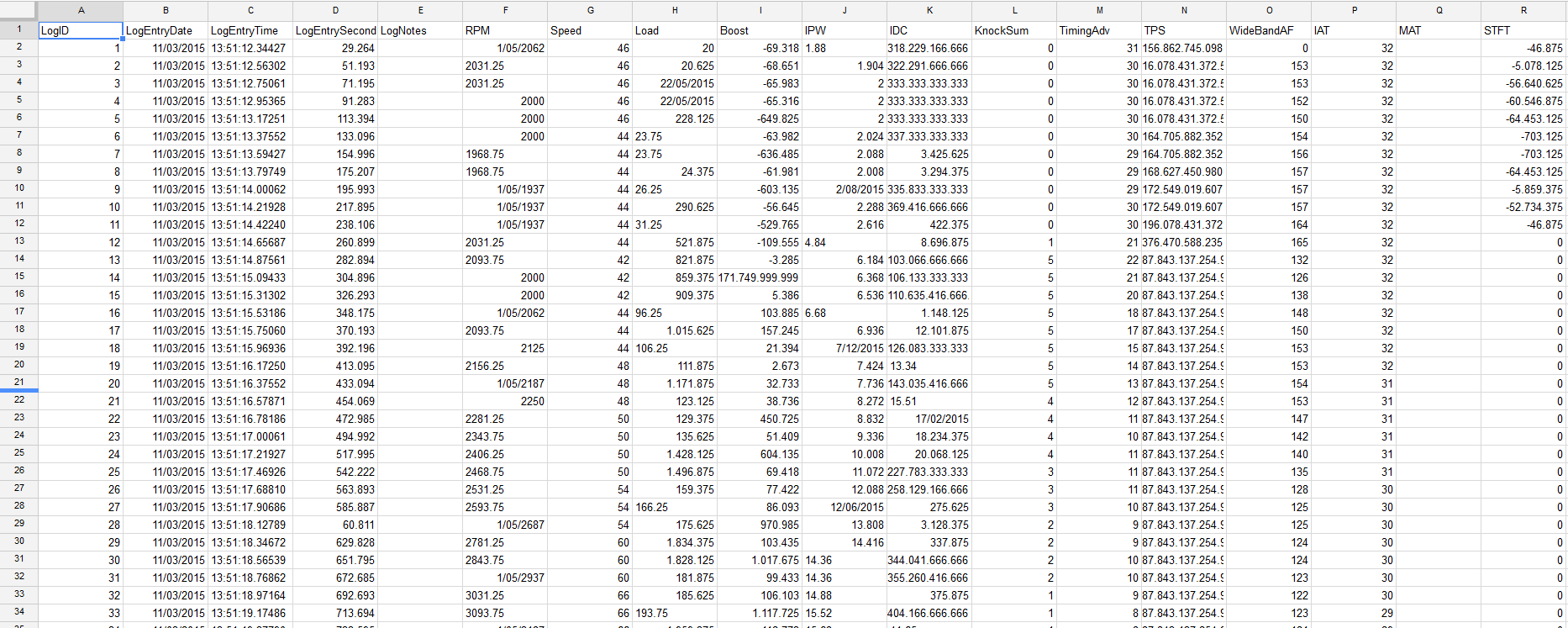

Hello.
I have an electrical issue and maybe somebody can help to me.
I'm logging to remap and when logging idle reads 10 times per second but when i logging 3th gear from 2000 rpm full boost only read 3/4 times per second... It jumps a lot of rpm, it's not enought info and it happens only full boost 2000-7000. I'm logging with a Samsung NC10 Netbook 2gb Ram & win7 32bit, tactrix, openport 2.0 and wideband aem with rs232 cable, i tried with another laptop more powerfull and another tactrix obd2 and with the better laptop only 5/sec... Better than netbook but insufficient yet.
I think it could be an electrical issue of the car (2008 X MR) but i have no idea which.
Thanks.

Pics of the issue. Help please.
imgur.com better thanks
None of these numbers seem to match up. Can you upload your log file?

At last i solved the problem. With Win7prof the logs are ok. I tried with another laptops and with 7home and 8.1 doesn't log ok, but with 7prof 8 and 9lines/second full boost.
