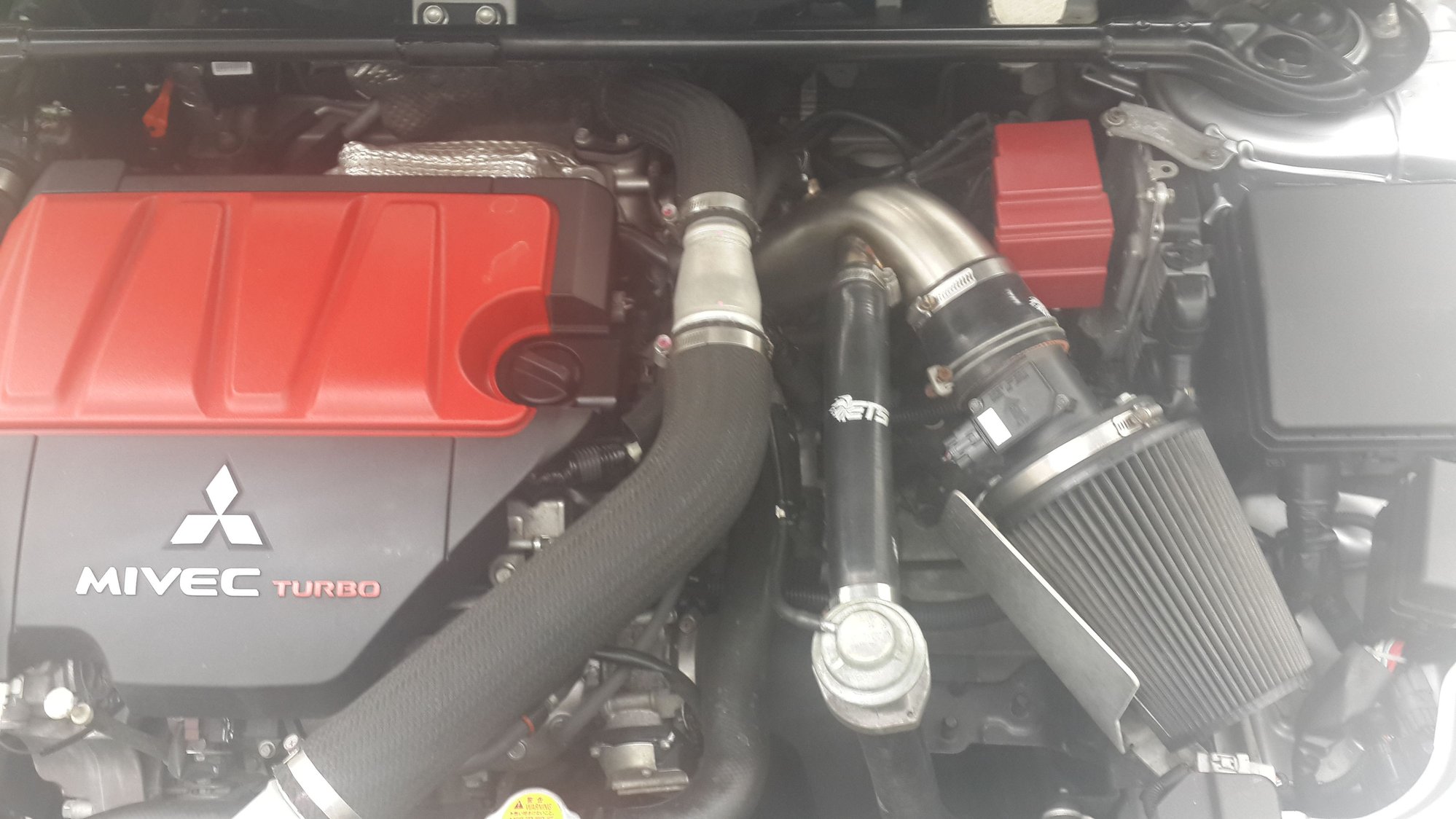

This first pic is of my engine compartment where you can clearly see the ETS setup
I actually removed this intake and pipes to get to the shifter bushings. Upon removal I noticed a bind on the hose that says ETS in this pic so I readjusted everything and no kink free...What is this hose for and what is that valve on the end? Blow off?

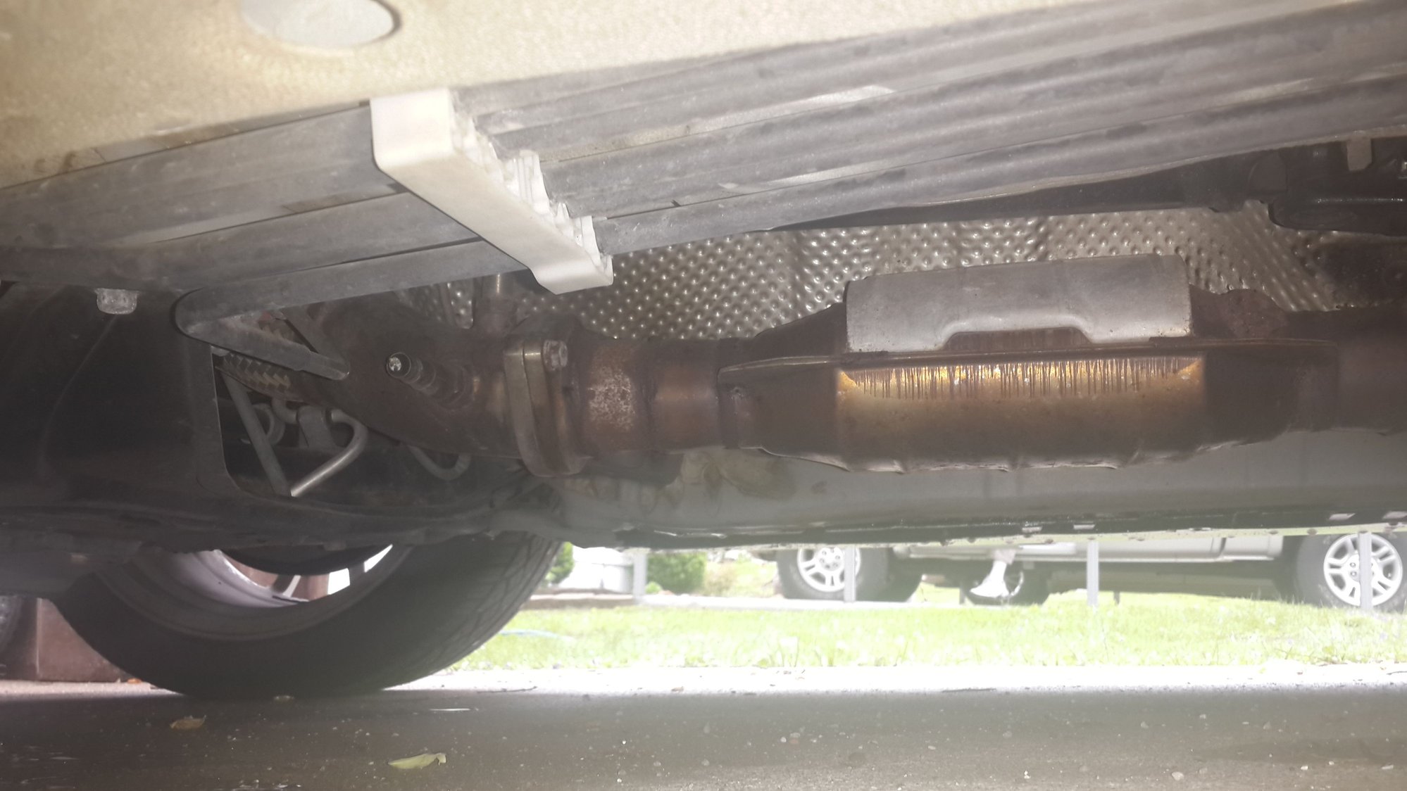

So I bought some AMS underhood shifter bushings hoping it would rid the 1st to 2nd issue I am having. Took the first one off and boom previous owner already installed this along with a short throw shifter (that pops like crazy in the console). So seeing all of these mods already installed, I was wondering what else was done so I did some research one this forum and learned that I also have an after market down pipe! While changing the oil I took a gander at it and the only writing I could find (slightly hidden) was the word "Turbo" inside an oval stamped into the side facing passenger side. Anyone know what brand this is? After that I decided to inspect and look around at any other suprises and right away I noticed a shiny pipe from the cat all the way back to the rear axel. With the sub-par weld job and shiny pipe it was clear this was yet another add on or delete. The muffler sounds great coming out dual but there is a Chrysler stamp on it! Is that normal? And with no resonator this exhaust sounds great! Any who The cat is small and I was wondering if its stock?

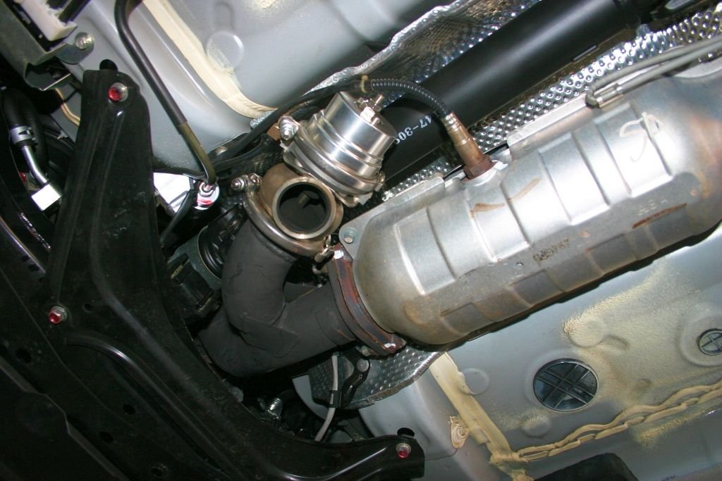

Notice the down pipe where they cut the 02 sensor wiring off...WHY? There is wired 02 sensor after the cat though. My question is why did they cut this and is that cat stock?

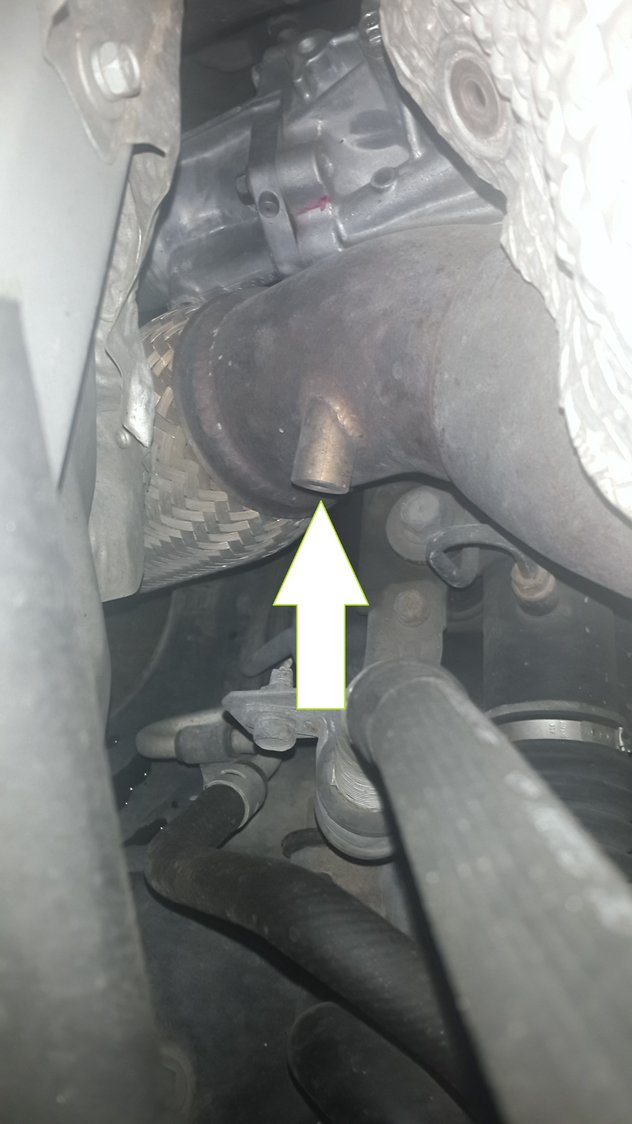

Last and not least. Looking from the engine compartment down at the down pipe I noticed an outlet" if you will. I'm not sure t the picture is at the top of this post because for some reason my computer is on the fritz and canthank you for reading!not handle this haah

Well! that thing is not the stock cat for sure. Here is the stock cat image (ignore the other thing not stock). It could be a hi-flow cat or disguised test pipe.

I am not familiar with the Evo cats yet, but coming from the VQ Family (G37s), we have stuff like this in our cats, acting to fool the sensors so your aftermarket cat doesn't throw a CEL.

The first picture with the arrow should just be a bolt hole for a bolt for a heat shield, double check to make sure it does not go all the way through. It looks like an ams widemouth downpipe, I have the same downpipe, and mine is just for a heat shield. The last picture of where the downpipe meets the cat or testpipe, definitely looks like the previous owner had a wideband installed and took it with him but left the wideband sensor. On the ams widemouth dp there are two bungs one for O2 (should be top), and one for wideband (should be side). If the top sensor on the dp still has its wires I am gonna say the top sensor and one after the cat are your two O2 sensors. Also, the hose that says ETS is just a connection from your intake to the blow off valve to make it a recirculated system. The blow off valve is what gives the turbo cars the signature pssssss sound.

Like Mihoerck79 said, the first picture is a bung for a stock heat shield from the stock 02 housing (downpipe). The second picture is the tubing that conects the intake to the BOV (recirulating) and will release pressure when the gas pedal is depressed. The BOV is stock. The third picture is of the wide band that was installed, was cut. He could of gotten a bolt to put there and not cut the wires. Could have been something wrong with it.
The cat is aftermarket. And with what you describe, sounds like it went to a muffler shop for a high flow cat and "new" exhaust system.

That looks like a Road Race Highflow cat. I have one that looks exactly the same.
