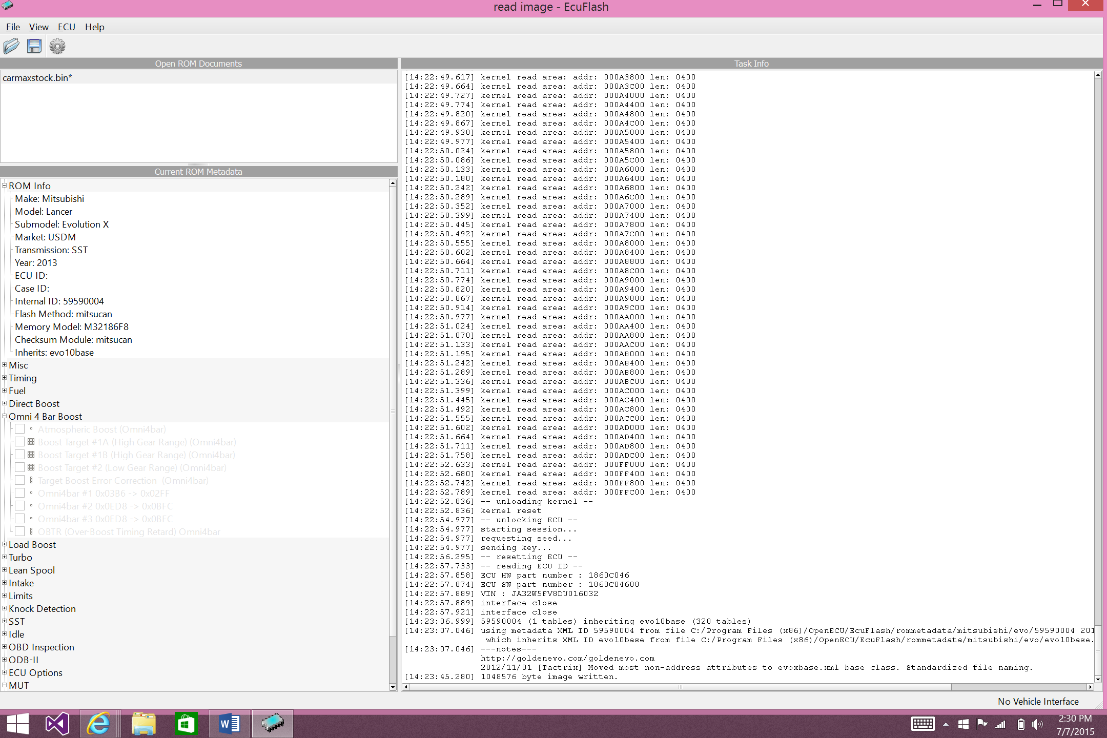

Unfortunately I won't be able to afford a tune until next month. As mentioned in my previous post my Tactrix cable came in today and I hooked it up.
Upon reading the existing rom on it I noticed in the notes it said: GoldenEvo, I had no idea what that was so visited it and it looks like a site offering a bunch of roms. I mean hands down this already voided the warranty with that, so I'm assuming I'd be able to contact CarMax back and be like hey this **** isn't even stock as you guys advertised, and see if they can take care of the fixes.
