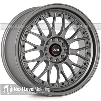

Does anyone know if the XXR 521 would have enough clearance to not hit the brakes from clearing??
Any feed back will appreciate.
Thanks guys!

You need to provide more information than what brand of wheel and model it is. You will need to know the wheel width and the offset to see if you will have any clearance issue with the brakes and the fenders.

Yep it depends on a lot of things the width, offset, tires you'll be running. Need more info than just the brand and style.

XXR 521 18x8.5 Flat Gun Metal 5-114.3/5-120 [+25mm]
I don't think these will clear the brembos.
Next size up could be either:
XXR 521 18x10 Flat Gun Metal 5-114.3/5-120 [+25mm]
or
XXR 521 18x10 Flat Gun Metal 5-114.3/5-120 [+12mm]
The +12 might clear the brakes but you would need fender work front and rear.
