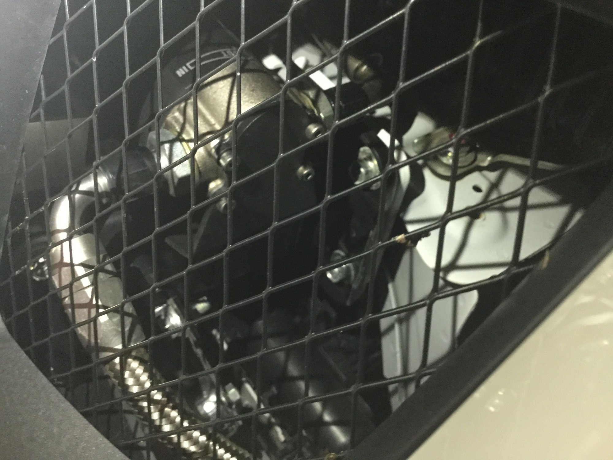

What the heck is this!? I'd want to guess a catch can maybe? Is it located behind the drivers side fog light?

Are those the "catch can" tubes running up there? Where are they going to!? they should lead to the valve cover eventually. Can you trace them out??

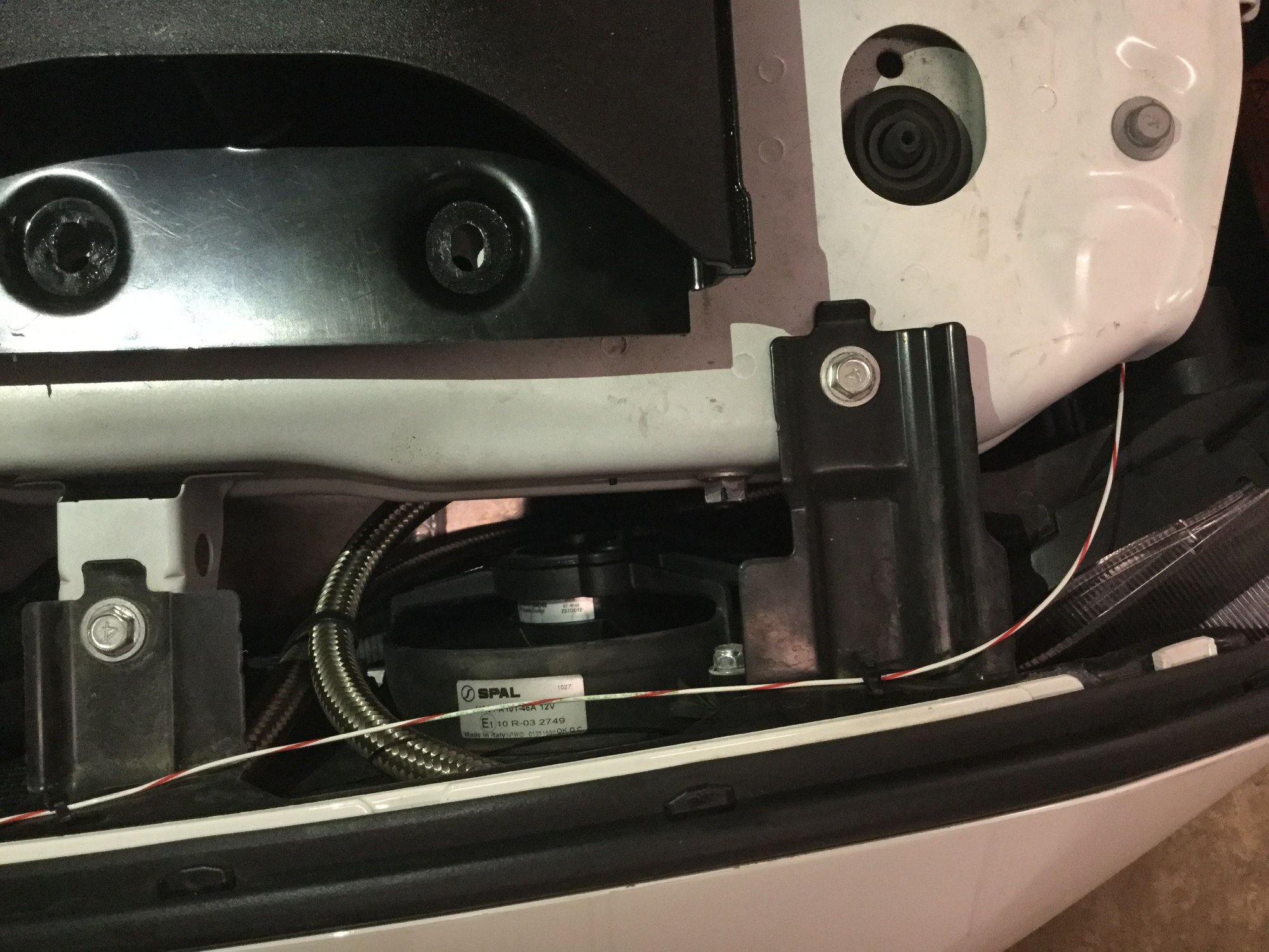

Can you trace out where this white with red stripe cable goes on both ends? I see it runs all the way past the UICP connection to the FMIC. I have no idea what this is for.

Where are the "catch can" tubes? I would have expected to see one of them connected here or up by the intake but don't :/. What are those!? Such an awesome mystery, I need answers!
No clue what that is for. Might be worth it to try to trace the other end of that cable. 30amp fuse is hefty, so that must be driving something requiring decent amount of power (i.e. not just some gauges).

Dude! looking back through this: There's a mysterious relay, some wiring that could lead down to a mysterious device behind the drivers side fog lights (i've been calling "catch can"). There's a mystery toggle switch in the cabin that probably ties into all that. Lastly, that "catch can" device has tubes that seem to run up by the intercooler and just stop. I wonder if this guy installed an intercooler sprayer system!!! how cool would that be!!!!!
My guess on the device behind the driver's side headlight...and the bit you can see behind the driver's side foglight mesh is an aftermarket transmission cooler. I watched a video of one being installed, and it was in this exact location. There is a SPAL fan connected to it that I tried to get in one of the pictures. The wiring and the "can" run an external pump for the trans cooler. I don't KNOW that's what it is, but yes, it would be pretty cool.

This mystery is solved.
What you see in these pics is an SSP trans cooler. Sweet!
The SPAL fan is connected to the cooler core (of course), and what you can see through the fog light mesh is the electric pump.
The 30 Amp fuse wired from the fuse box powers the unit through the relay that can be activated (only when the key is on) from the red toggle in the compartment above the shifter. The tiny red and white wire spanning the front area goes back to the firewall and runs to the toggle switch. Better than an intercooler sprayer, I'd say

Great find and those are like 1100 just for the part, that clean install must have been a pretty penny.
