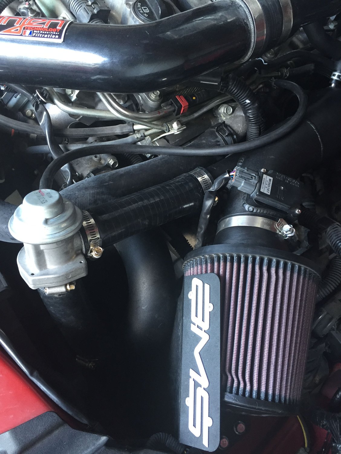

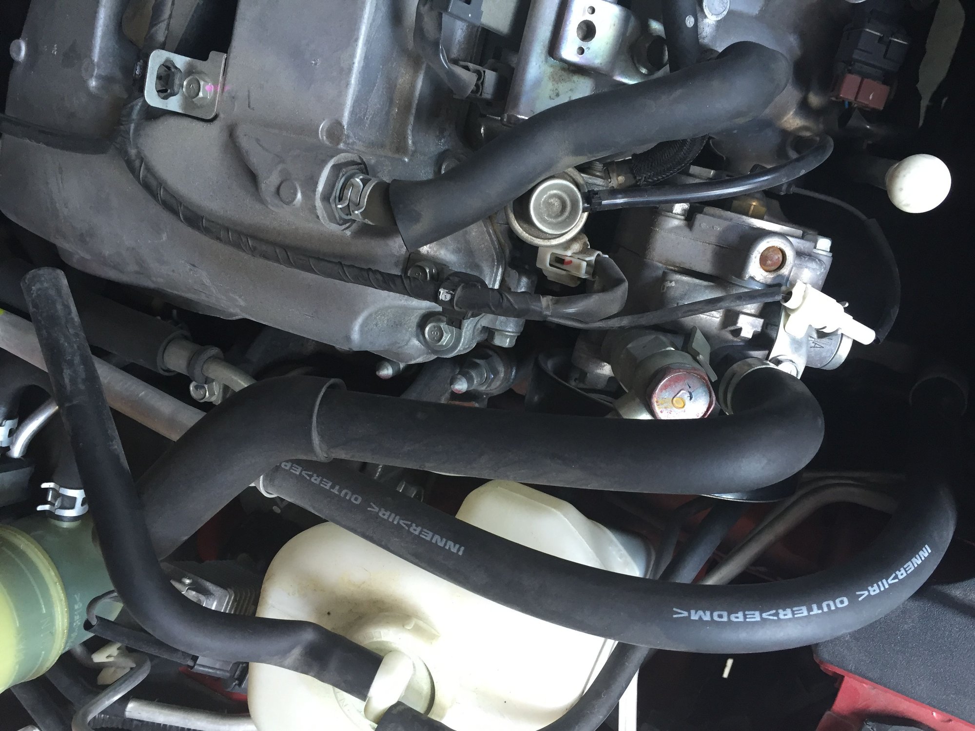

This is where the coolant is and the fuel pressure regulator. The coolant hose is free

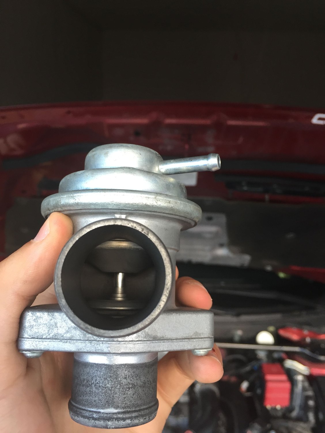

Bov

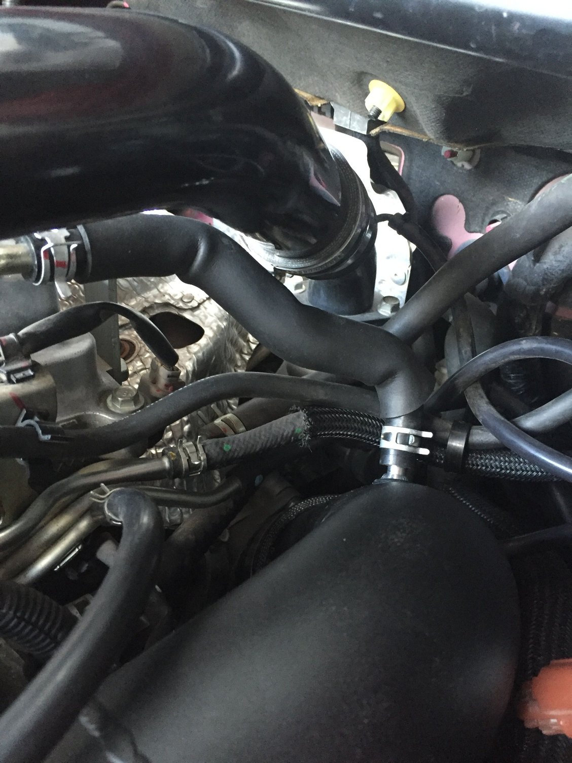

Intake and Bov

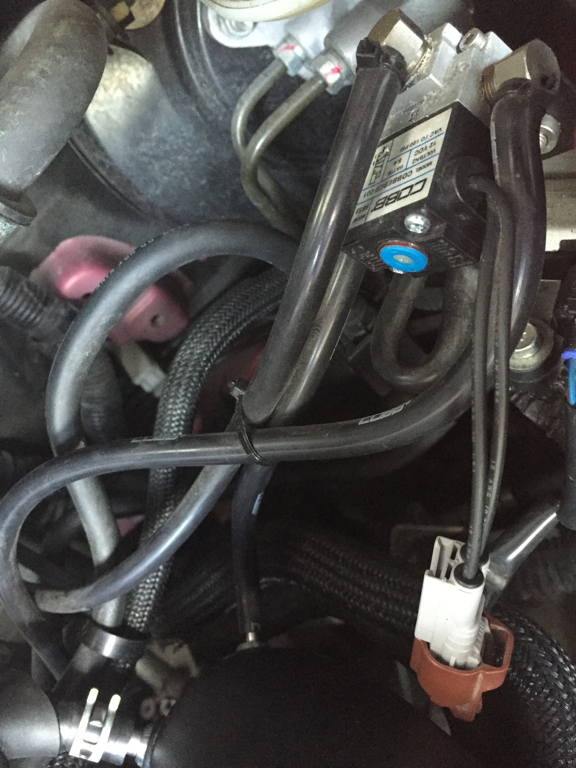

This is the crank case hose
3port BCS

Coolant hose is normal. Mine is the same way. Everything else "looks" fine. Obviously a little hard to tell without actually being there. Did you end up checking all the clamps/boost leak?

Dont' worry about the coolant hose going to nowhere, mine doesn't even have a hose connected. I think it's a vent. If you take out the coolant cap, you will understand.

that coolant hose is normal, thats the dump to vent out in case it overflows. Bov looks good, check the line that attatches to the BOV and follow it all the way past the metal pipe. Unless its bypassed now
