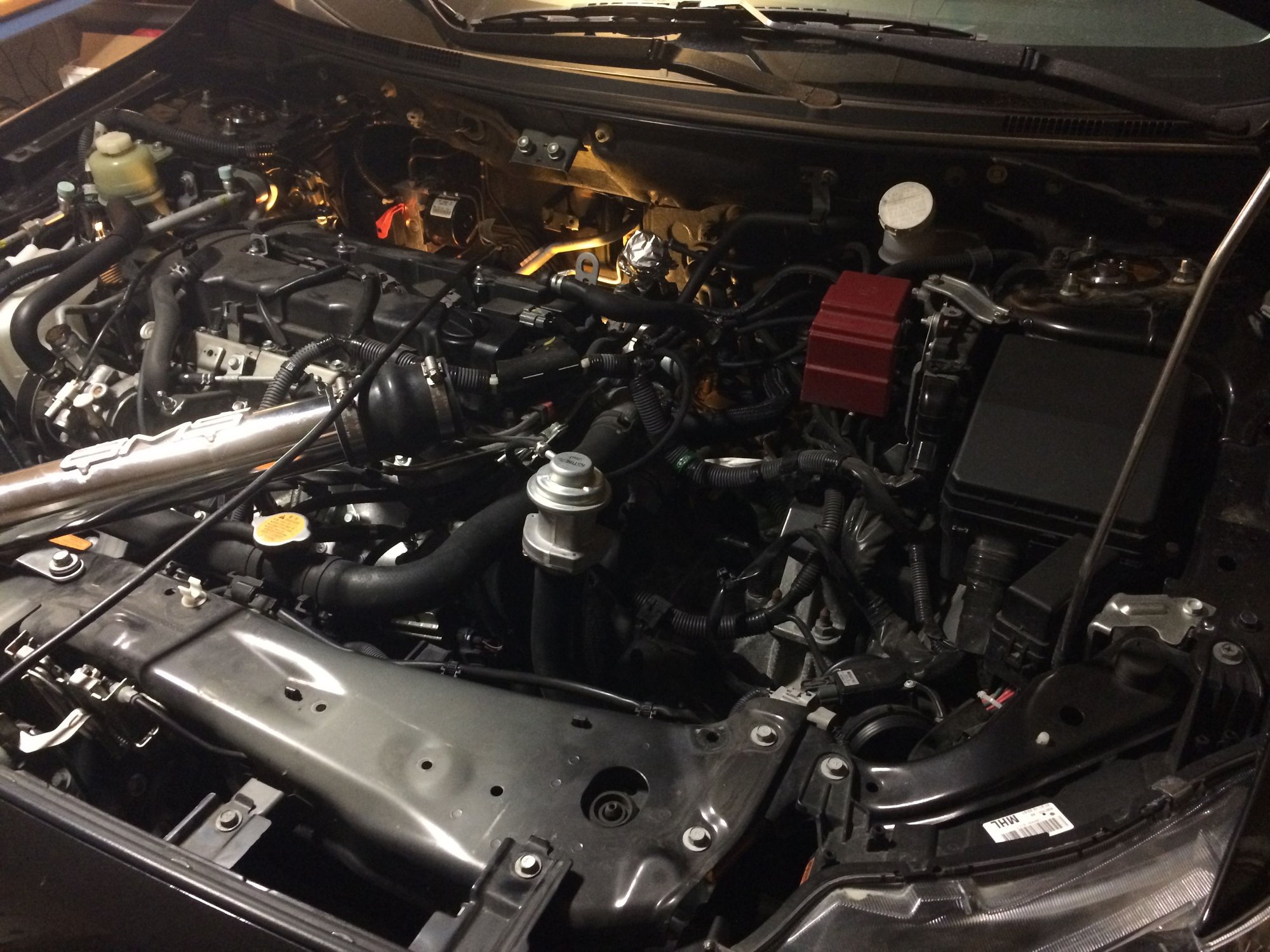

Originally Posted by jakgal04
Well I'll be damned, when did the stock GSR bpv switch to plastic? My 08 is metal.
Not sure what OP is talking about. No Evo X has ever come with a plastic DV. They’ve all been metal.

The Evo X GSR clutch master cylinder is plastic and known to fail. The Evo IX was metal and stronger and it is common for people to convert to the Evo IX CMC when replacing the clutch. Maybe this is what you are referring to? On a stock pressure clutch it is mostly a non issue and Mitsubishi had a recall on it years ago to replace with a stronger plastic version.

Here is a picture of my 20012 GSR with stock valve. It's as metal as Slayer. Magneto could rip it from the car with his mutant powers.
I did a little research on it. Sounds like the Evo 8 base model had plastic and MR was metal. Im pretty sure all X's are metal. The Raliart is plastic as well I believe.
