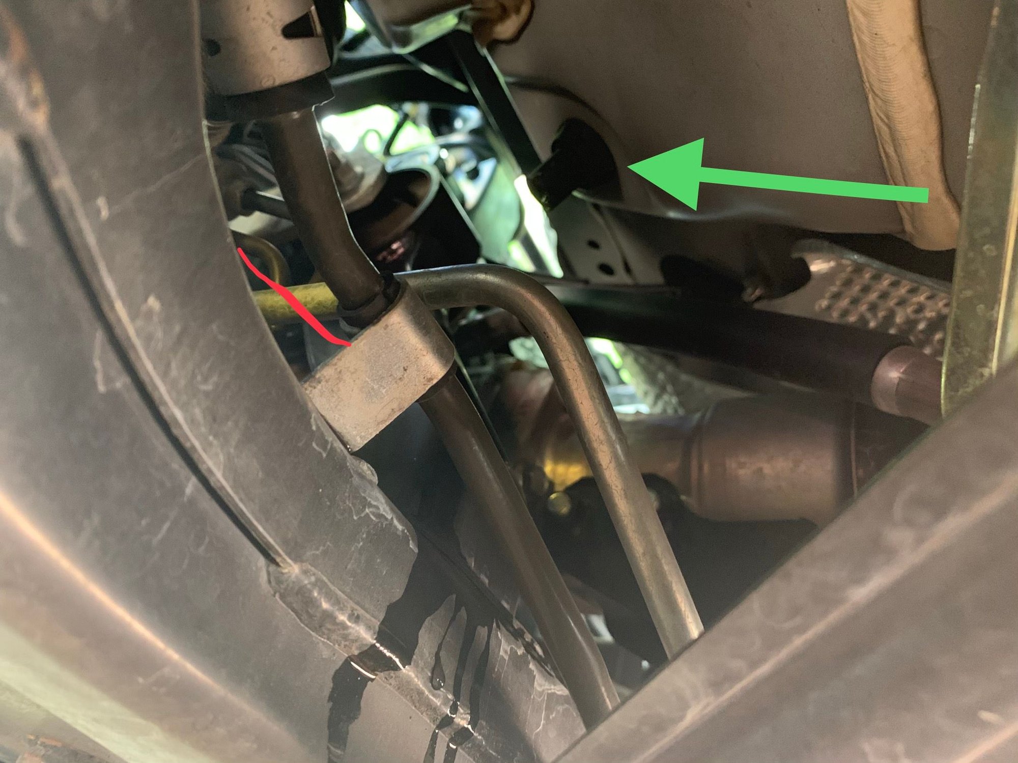

Drove to Oceanside,Ca roughly a little over 2 hrs up and back to pick up a part today. Speeds around 65-75 mph. Weather wasn’t too crazy. Hottest I saw was 85. Did have the A/C on. Got home and checked to see if everything was ok. Looked under the car and saw there was this leaking. Seems to not have a color nor a smell. Possibly just water? Was hoping someone can help

You answered your own question. AC Condenser

According to this thread, I’m fine right?
https://www.evoxforums.com/forums/sh...#/topics/70983

You're fine. If you plug that up you'll have a soggy carpet and mold in no time! It's the train for any moisture that condenses inside the dash HVAC.
