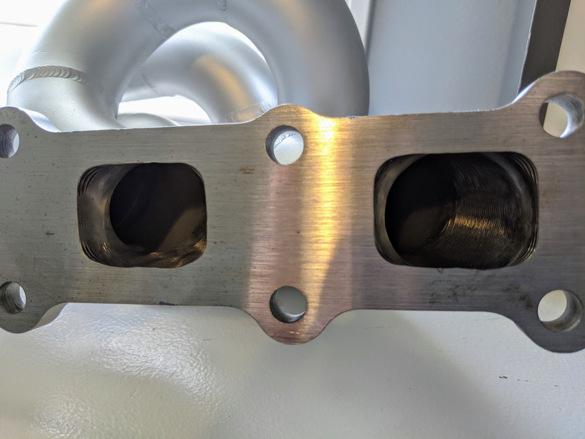

I have the Sheepy Manifold and, although it's really a beautiful piece and SOLID, I think I would go with MAP's cast manifold for a stock frame turbo. You can utilize the factory heat shield, it's probably less likely to crack, and $50 is $50
I'm not super happy with the transition from the flange to the header tube which is an issue MAP's casting doesn't have:
