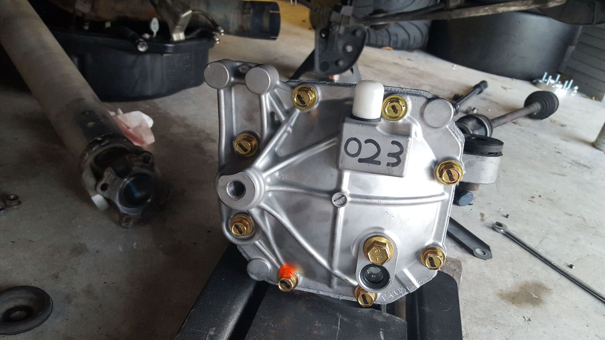

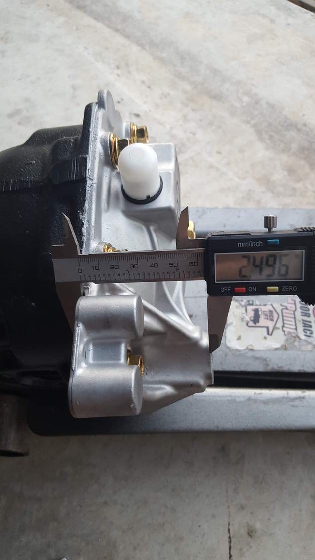

I used a cz4a ralliart diff and used none of the extra stuff (other than the ralliart axles). Used the x differential ears.
Sent this bad boy off to TRE to get rebuilt with 12 clutch discs and added a rear cover sight Glass. The only extra thing I used was a longer rear diff bolt. It's been like 7 years since I did this mod so I don't remember the dimensions, but I think it was 105 mm in total length. Measure the dimensions and make sure you get a bolt that fully seats inside the diff cover bolt. Additionally, you'll need to stack some extra washers because there will be a small gap between the cover and the differential mount. I think I used three washers there.
