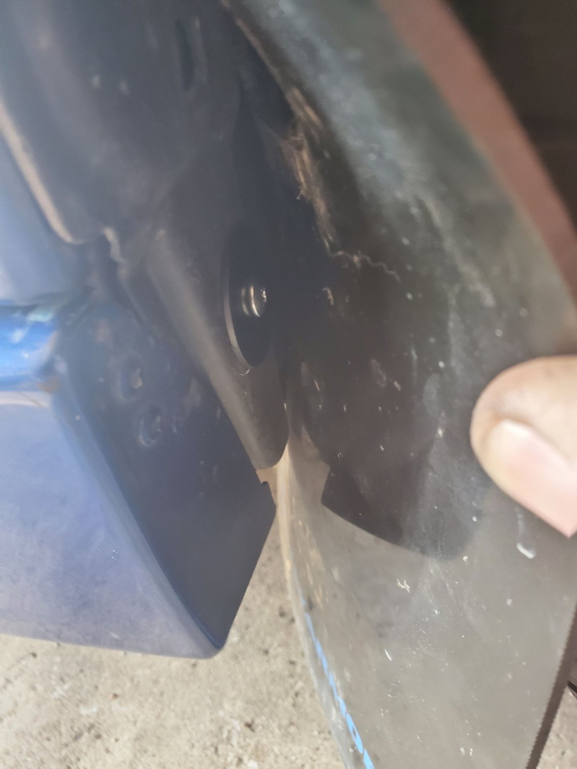

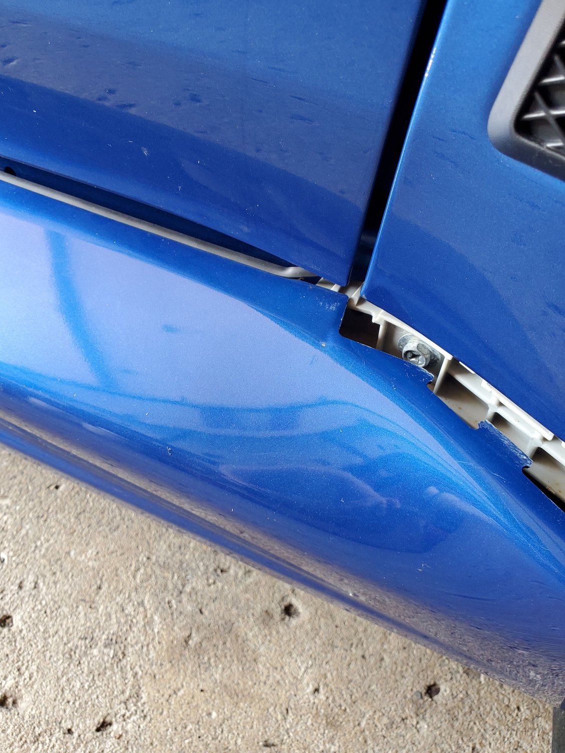

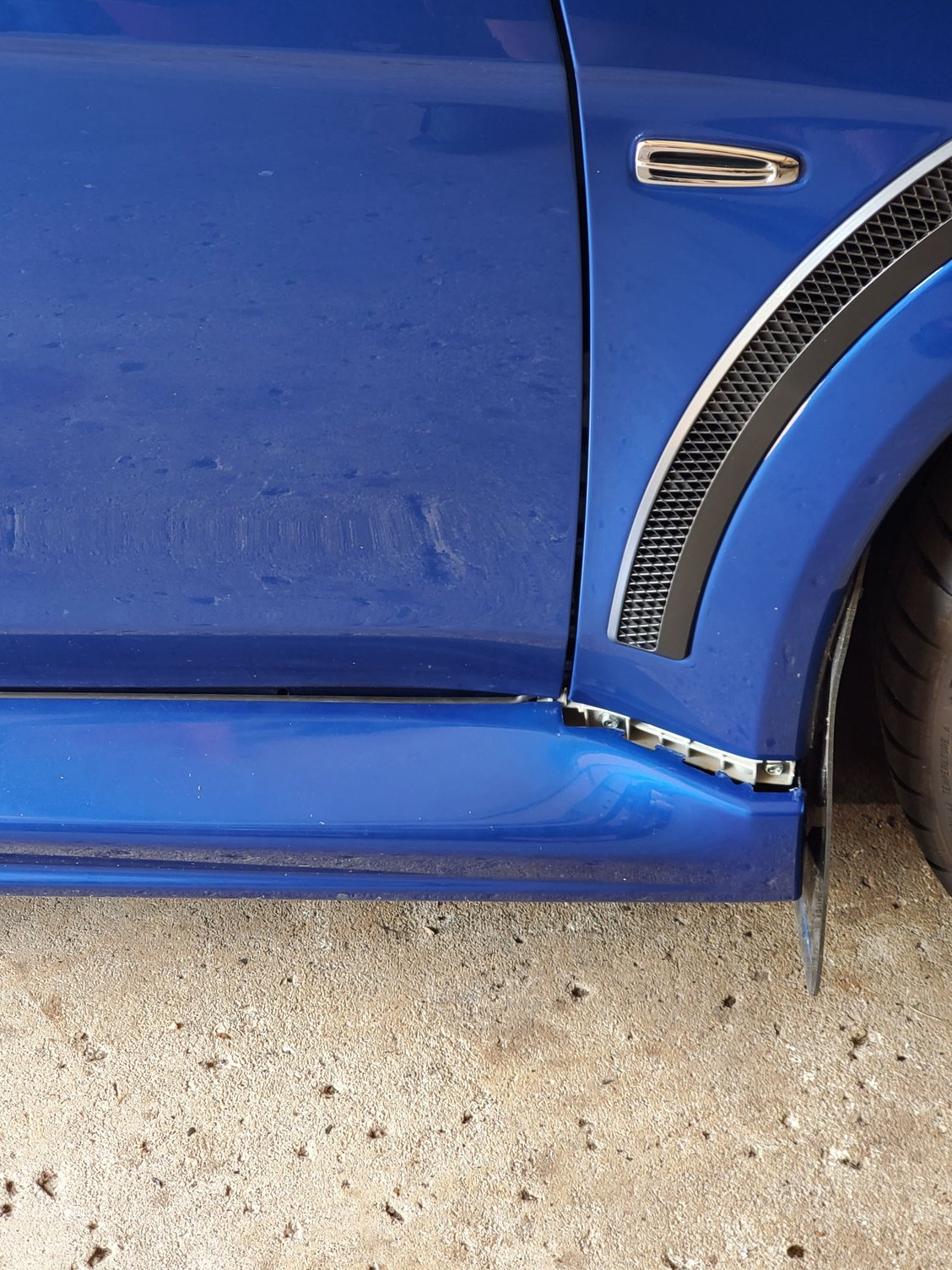

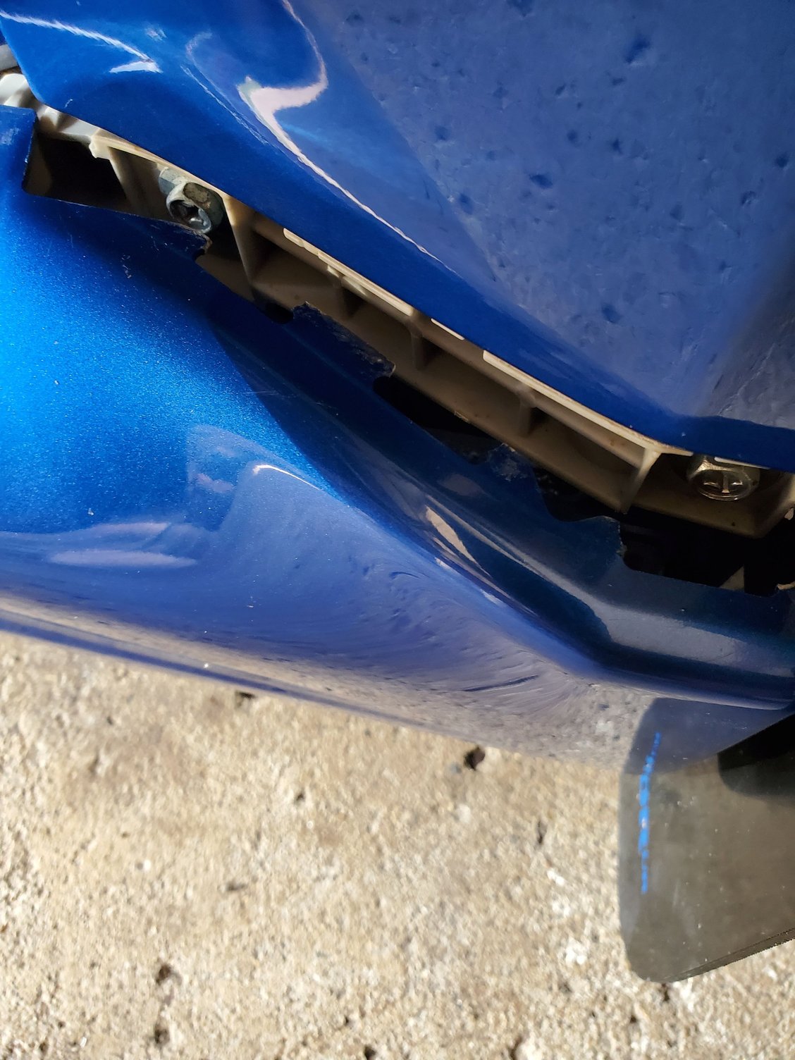

I just finished taking off and looking at it. Whoever did the install on the sideskirt did a horrible job. Alot of the holes that the plastic clips go in are broken. So it was impossible to clip them back in.. i ended using a washer and screw. Here's a picture. Its a temporary permanent fix as I plan to get a new body setup eventually.
