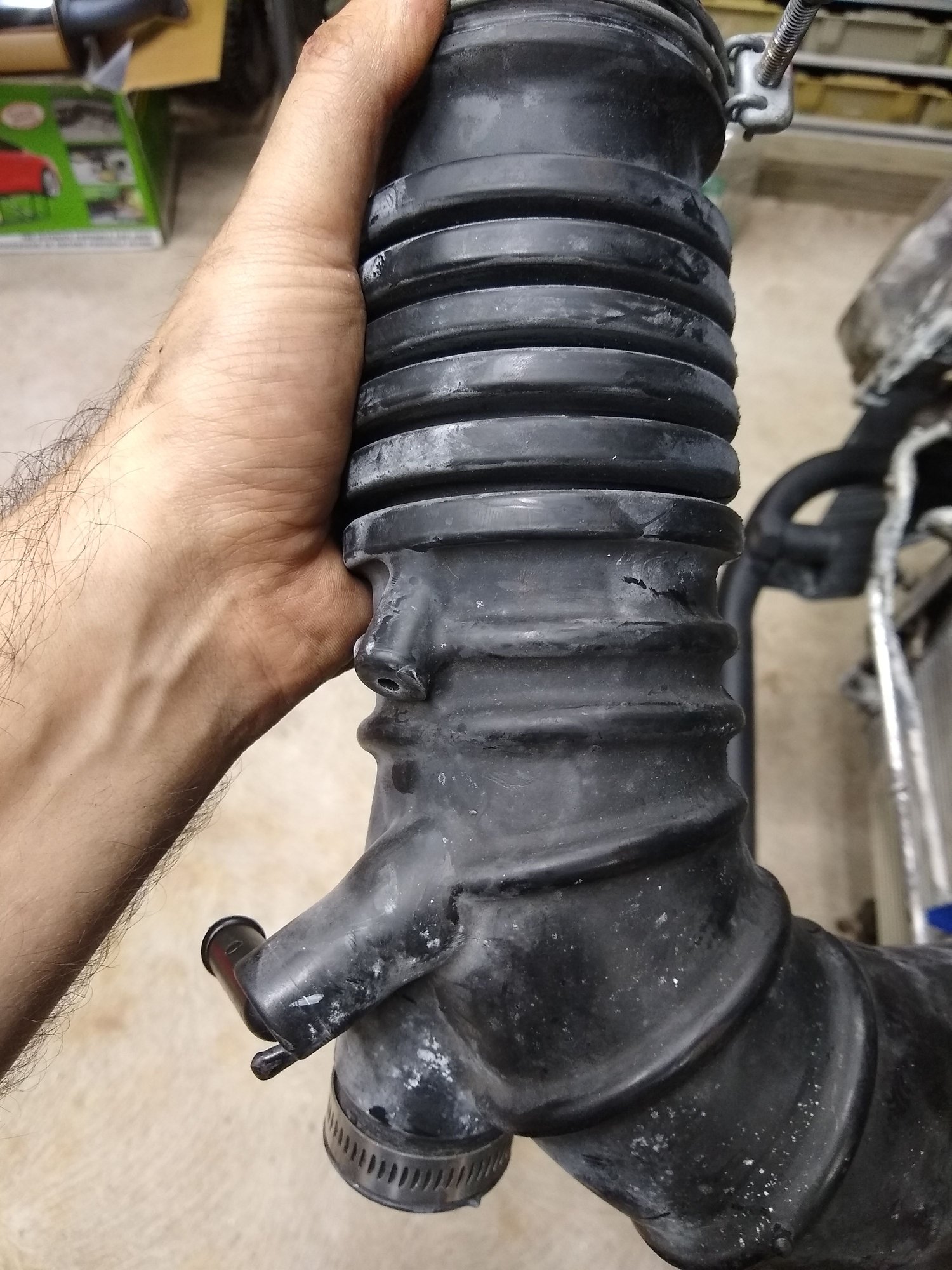

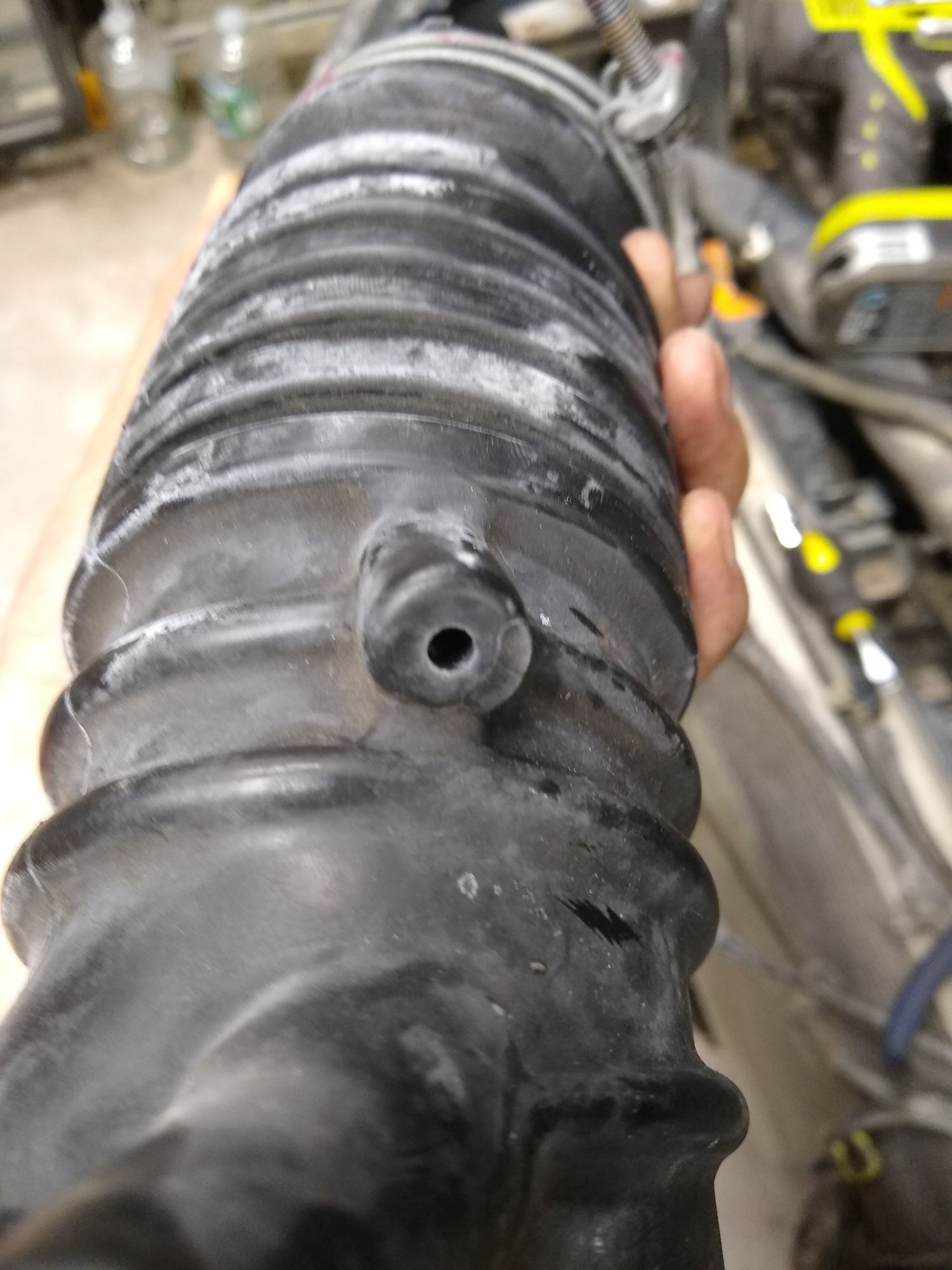

Does anyone know where I can find the vacuum fitting for the factory intake or something that will fit? I have the 90 degree elbow but not the straight fitting.

I didn't see an OEM part number for it either.
Has anyone found a regular fitting at a parts store that will work? I've been keeping an eye out for one for sale\part outs without any luck.

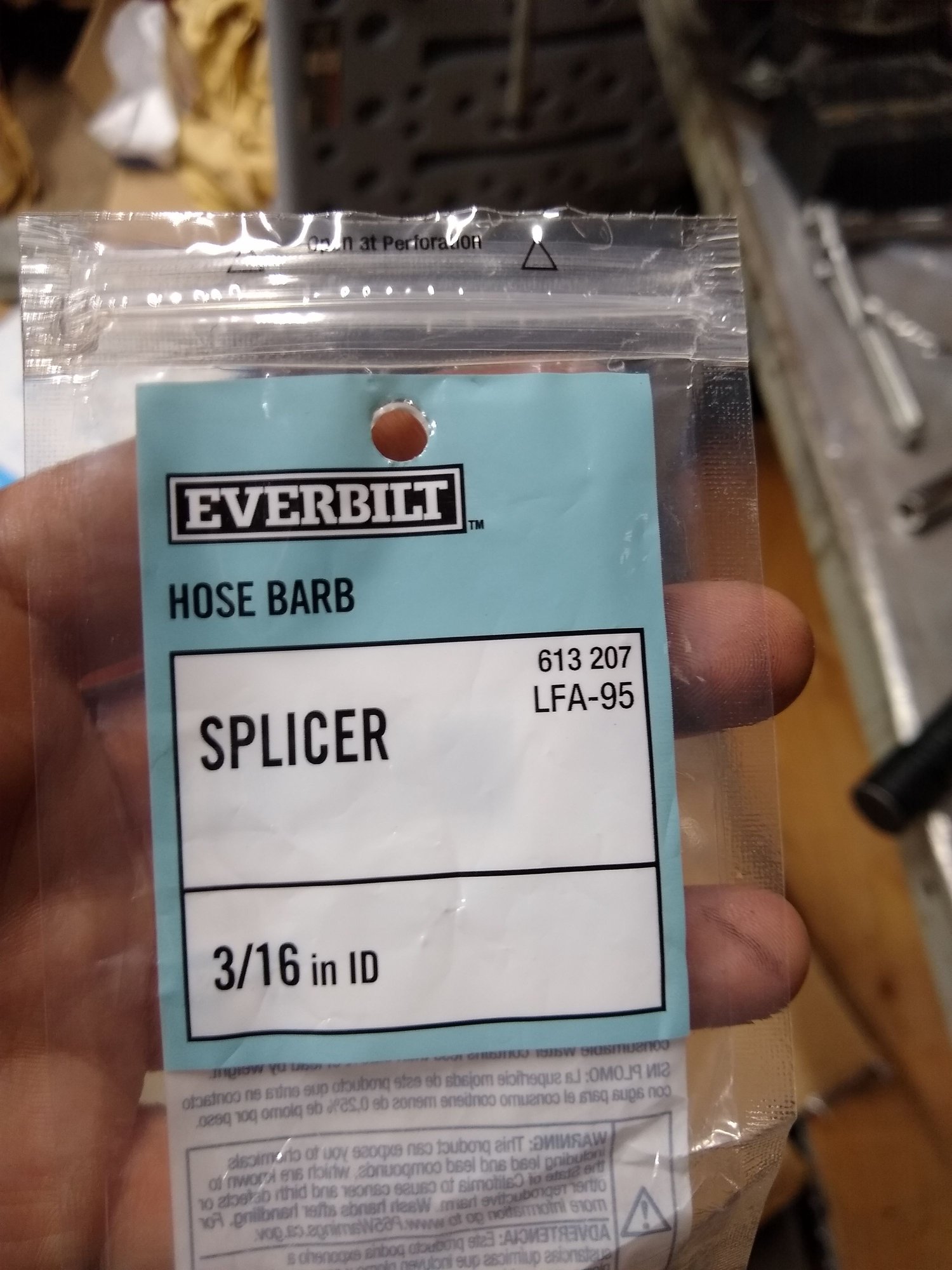

I found this 3/16 barbed joint at home depot. Worked great and only cost $3.61
