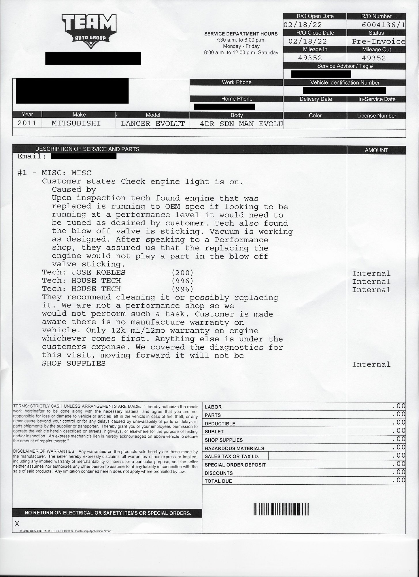

Whelp, the latest news is that all along the BOV was messed up!
Drove the car home tonight, had the guy turn the code off, code hasn't come back on yet, so maybe all this time it was the DAMN BOV!!!
Which I didn't know. Since I could hear the swishing noise. And when Eric and I went to the rock show about a week ago it worked just fine, then all of a sudden the thing froze up, and that's when it needed to be cleaned.
So, I guess the valve was opening somewhat to make me think it was working well, but in reality, it wasn't. And I've been bothering the people at the dealership ever since I had the new motor be put into the car
So, I'm looking into getting a brand new BOV, instead of going a used route
https://www.maperformance.com/produc...x-ts-0215-1022
https://www.maperformance.com/produc...-9-evo-x-t9033
Looking at those two, Like the price of the GFB.
I pretty much got a polite and professional 'GO POUND SAND' from the women service writer today. As in go away, get a tune. They, actually had to call http://rrtmotorsports.com/ which is in Canton, CT to have the main guy there try to help them out with what the problem was with the car and the damn service engine soon light that won't go away. But, from what they said the engine is performing as it should. Keep in mind that my car sat in their garage from August 1st of last year to the Nov sometime. And also the BOV does collect a lot of dirt and grime. I looked it up that you should maintain it every six months.
But at any rate that's my story.
Thanks for listening and trying to help.
