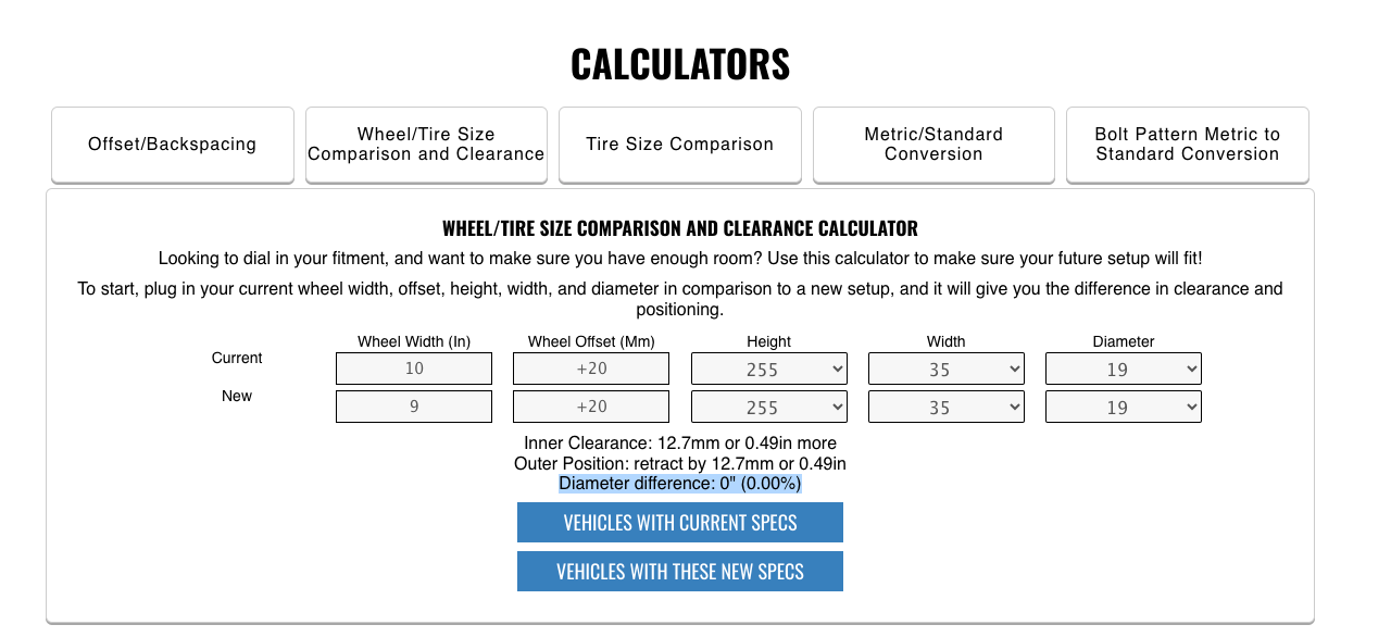

Hi I recently got hold of some rare ame shallen wheels.
They are 19 inches However i found out that two of them are 9j and the other two are 10j.
The offset is the same on al wheels at +20.
My question being: keeping the rolling radius the same on all four wheels would 255 35 19 on all fours be good?
My car isn't lowered, it's purely all stock suspension, stock ride height and i have zero plans to lower it.
Here below is the comparison of a 255 35 19 9J vs 255 35 19 10J. I've obtained this data from a site called "willtheyfit"

From what i can see the diameter of the wheels has no difference between the two rim widths, only that one rim will have more of a poke than the other which i do not mind at all.
I'd understand if the wheels were different sizes (for example two being 19inches and two being 18inches) that this would affect the AWD but i cannot see how the width will affect the AWD system when the rolling radius is the same or has such an insignificant difference (a few mm or less).
