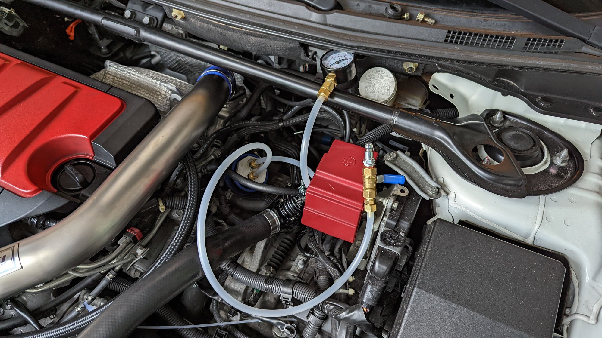

Is it the stock turbo? If you remove the entire intake, leaving the recirc valve, you should have enough room. You might have better access modifying this tester. This is the one I made for my 10.

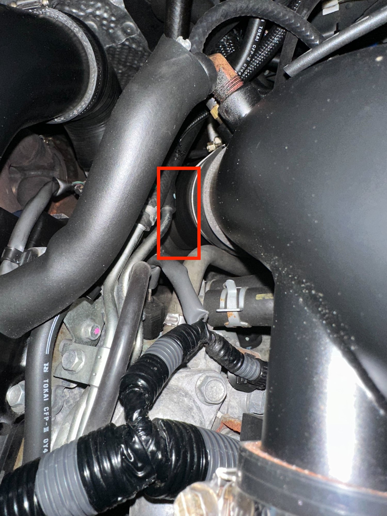

I'm not on the stock turbo. I have a BorgWarner 7163 with a custom manifold and downpipe from CBRD. The turbo sits pretty low. Here's a pic of where the turbo sits in the engine bay:
Guess I'll see how bad I want to get to the turbo and do the test
