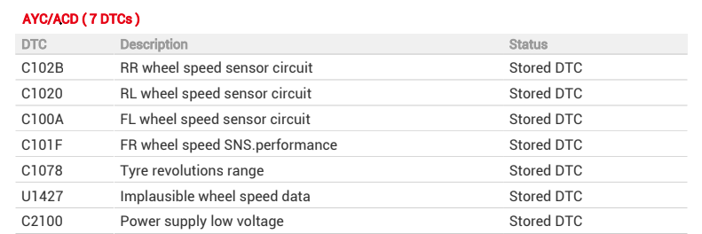

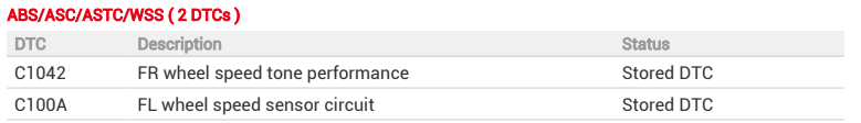

Whats up everyone I was wondering if someone could help me out, recently i replaced my clutch on my 2015 Lancer Evo X Final Edition and ever since then i have been getting ABS/AYC/ACD codes.
I bought an Autel Reader to help diagnose the issue, i was able to clear the codes, drive the car but my speedometer wouldnt work for a while until i was well over 50mph. Bought new wheel speed sensors all the way around, because was going to be doing control arms, struts, stabilizer bar links, pulling and resetting the cv axles, checking the transfer case, to make sure its seated properly anyway.
After replacing everything and making sure everything was where it should be, we used the autel reader to clear the codes once again, the good thing is now that my speedometer works all the time but even after resetting the codes after driving maybe 500ft or so (not very far), they come right back on,
Any guidance or advice would be greatly appreciated. hope the pics give you some information that i am not able to off the top of my head
Edit: Codes will not appear when the car is sitting idle, but only come on after the car moves. ABS light comes on first then the AYC/ACD light behind it and my 4WD right after that.
