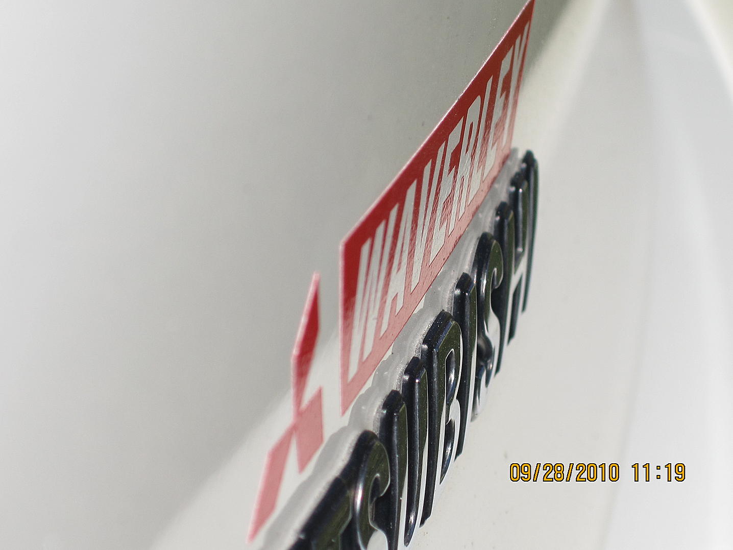

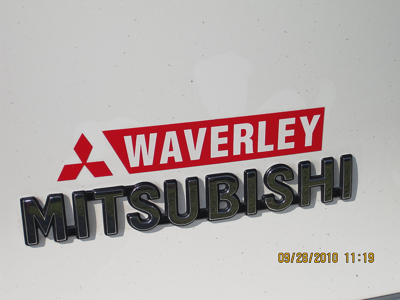

What about this garbage?! Cant get behind it with fishing line... Squirt Goo Gone and heat it up and pick at it with your fingers? Would that work? Stupid f****ng dealers.

you need to compound it and then rewax afterward, easiest way is to just compound it and wax the whole car so it looks fresh afterward
Attachment 159351
Attachment 159352
Heat, and carefully remove with credit card. if u heat it enough u shouldnt need much force to scrape it just becareful
