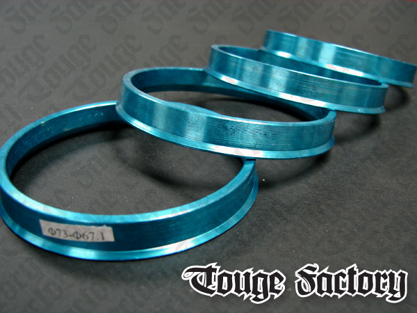

Originally Posted by Touge Factory
As mentioned by others...
Not needed but recommended.
We have blue anodized aluminum rings in stock.
67.1mm / 73mm

I also second the recommendation about getting either aluminum or composite rings. With some track time I had the plastic rings completely melt, deform and in the fronts flow out of the space they inhabit. (Rotors will glowing blue at that point.)
The aluminum ones do have one issue and that is they tend to fuse / weld themselves to your hubs with enough heat and track time. That can be partially cured by using a some high temp anti-sieze between the rings and the hub.
67.1mm / 73mm
Can you send me a price for these rings I need some for a EVO X with 18x10.5 +15 te37sl, thanks

^i got mine from them 28.99 shipped.

here's the link
http://www.tf-works.com/tf-aluminum-...67-1mm-x-73mm/
they're red though. but i guess you could choose the color because when i called them the guy said they come in anodized blue but then i said i wanted it in red then when i received it and opened the pack they sent me a red one. call them first and ask.
