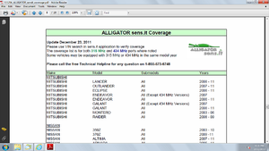

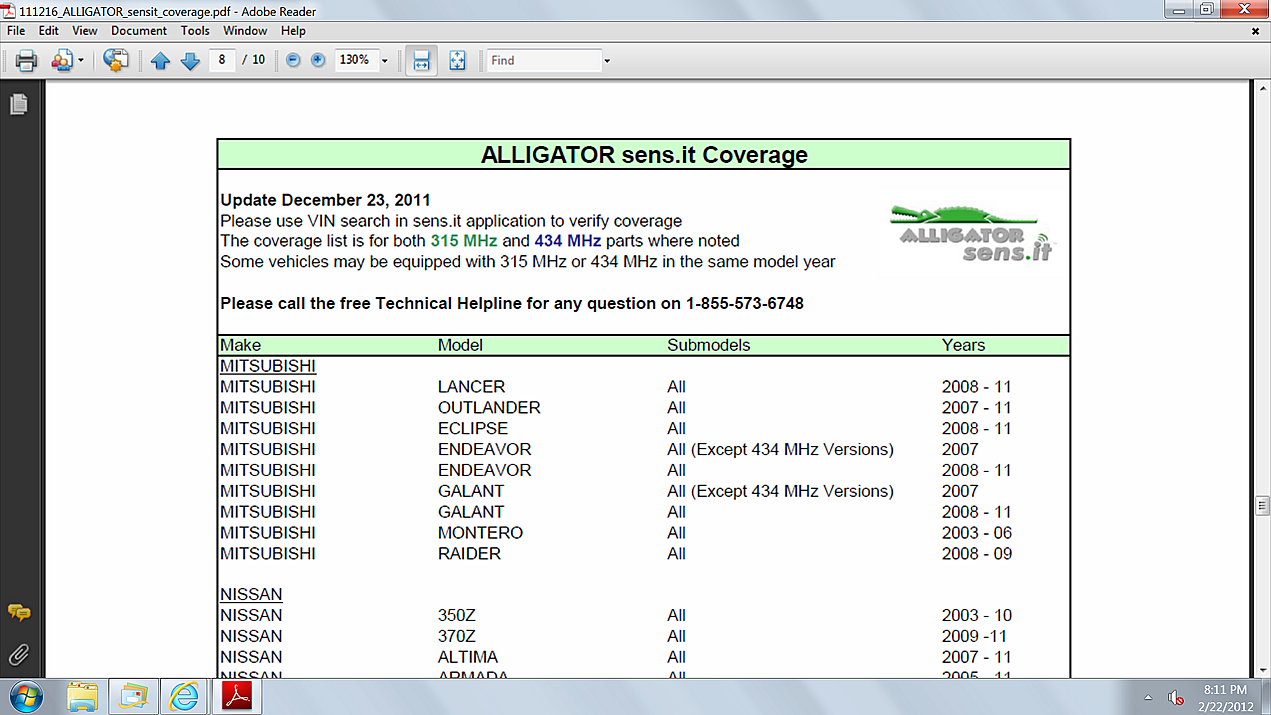

Here is what I have ordered. $200 plus the cost of the 4 sensors. Web based so never any need to update the tool. According to their chart they have sensor coverage for "ALL" 2008-2011 Lancers. All you need is your 4 sensor id's whether you get them from an obd scantool, tpms tool or manually breaking down the tire. Should have everything in a few days and hopefully be able to confirm that we have another possibility................
http://www.alligator-sensit.com/

SUCCESS! "sens-it" is a go. Programmed 4 sensors for my car yesterday and my idiot lights went off in an 1/8 of a mile. Full comminucation looking at sensor data through the OBD port. Going to start a thread at some point with pics and info.
