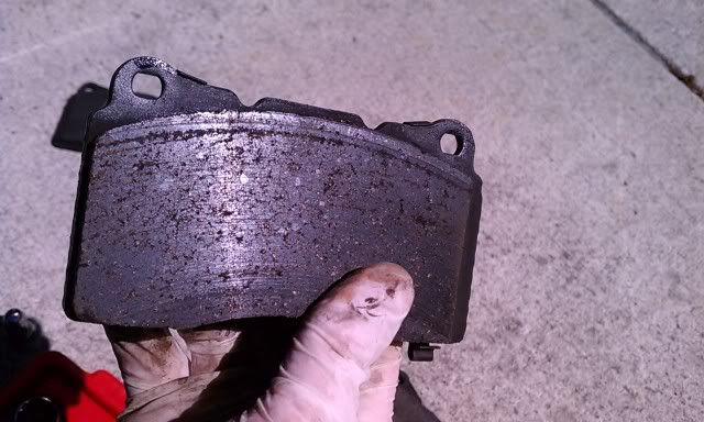

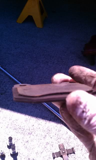

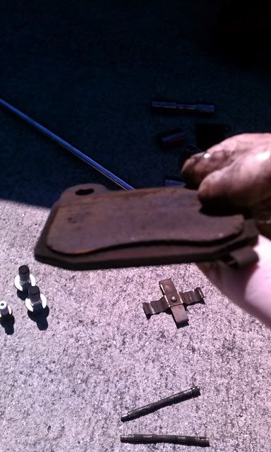

I plan on moving this thread to a more populated area as to get it a bit more attention. It has turned into a problem with the seller and I feel I should warn others as he is trying to sell parts on this forum. He still claims to have taken care of the car and that all damage has occurred after the car left his hands.
Here is what the rear brake pads look like:
Here is one of the fronts. On the side that wasn't bolted in, this top line is very heavy. Sorry, my Droid pics don't show the indentation too well.

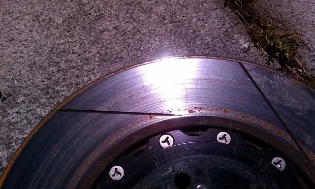

And here is one of the front rotors. Again, sorry for the Droid pics, but you can see where the rotor is cracking and in poor condition.
According to him this was all caused after the car was picked up (maybe 300 total miles). I have only put 10 miles on the car total. The last 2 cars that I've sold I replaced the brakes for the owner (or in one case I bought him new brakes entirely) because of how dangerous it is to have really worn brakes. Neither car had bad brakes that I sold, but I didn't want to chance it. If I was offered some kind of compensation then that's fine. But to completely absolve blame of himself and make it out to be my fault is not ok. I would imagine that he wouldn't hesitate to do it to another member on this forum. I will release his name when I start my new thread.
