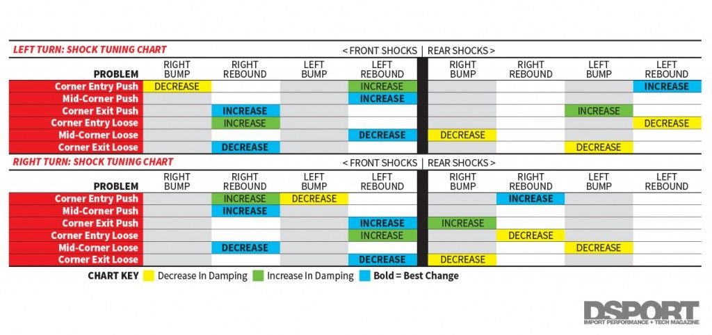

One way or another, I think this chart posted in the article is informative for bump and rebound tuning:

For all you people with single adjustable bump/rebound adjusters.....good luck with that.
That actually is pretty interesting. 👍
