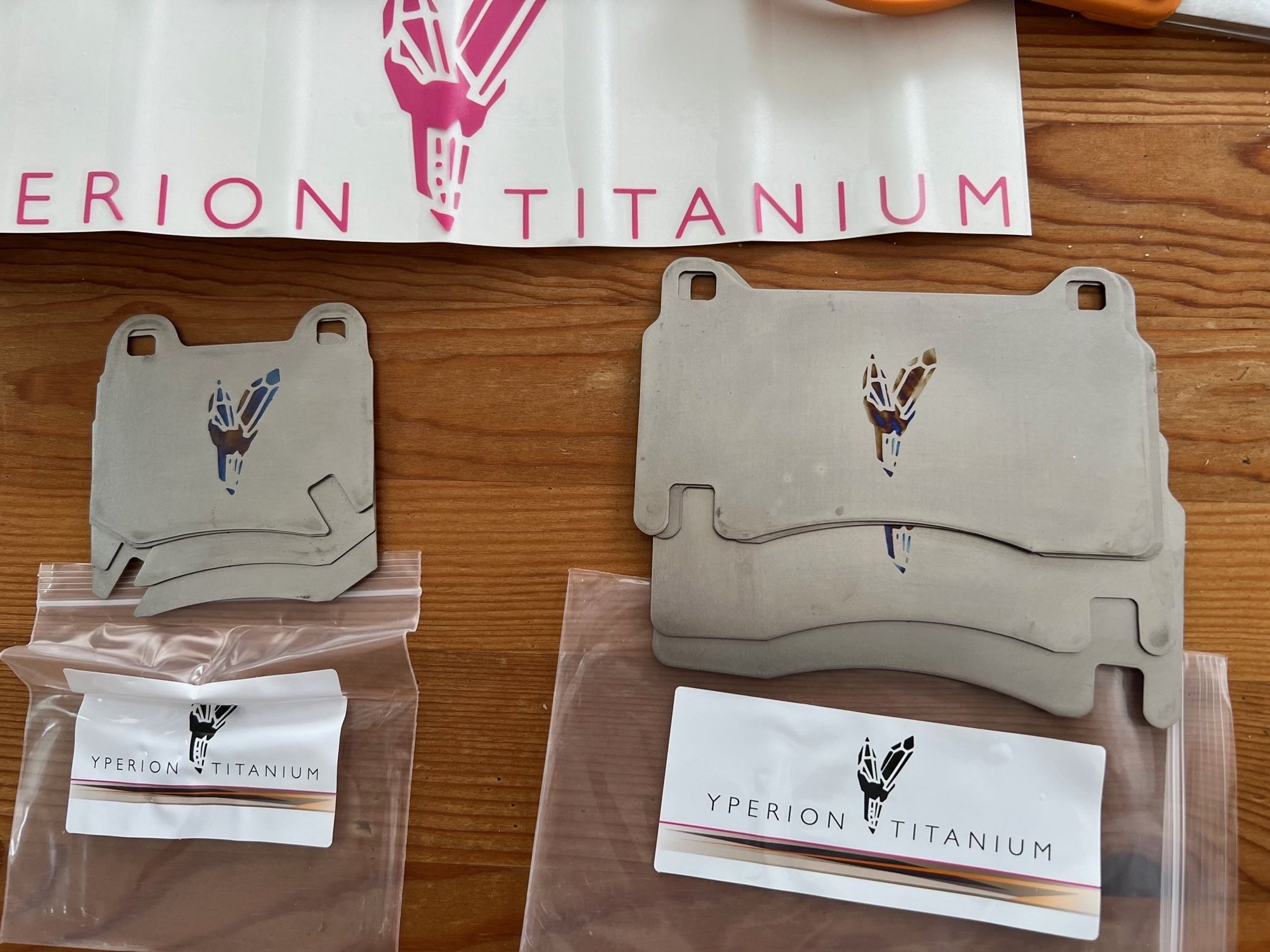

Just wanted to let everyone know that I received the titanium brake pad shims from Yperion Titanium today. It took exactly one month to get here but I was able to track the package all the way, there were no problems at all with shipping.
I'm waiting for my Ohlins coilovers to arrive from Works Motorsports hopefully next week, I'll install everything at once with new rotors and pads and test everything on Sept. 16th at TGPR before the time trials at Road Atlanta.
They look really good!

0.8mm front, 0.6mm rear. It got here in a month, I was able to track the shipment all the way and communication with them was great.
I had two track events with them (SCCA time trials at Road Atlanta, track day at TGPR) and I had no issues with the brakes.
