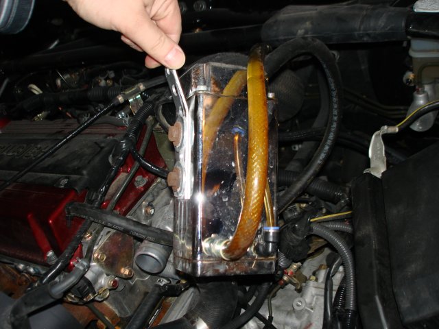

Does anybody know what is this? For sure not stock box.

Mayb Oil Catch Can

Yep catch can

Definitely a catch can.

Catch can it is........funny, youre holding it like some dead carcass that was picked up from like some flattened road kill lol

Oil Catch can

Looks like you might want to empty out the catch can.

How'd you know it is full? What is the benefit of having this oil catch can?

I was trying to do best photo shot, flash was bouncing everywhere.

it catches your blow by ,and prevents oil getting inside your turbo inlet pipe,and intercooler..and when u get oil get in your intecooler you will lose power........clean it up and keep it looks like it defnitly doing it's job......
