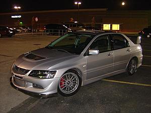

Cosmetically the Evo 9 does have nice seats, however we tend to think things that are different are better and a nice leather package from and 05 Evo 8 is just as nice as the leather seats standard in the 9, so that's a matter of opinion. Some people like the Evo 8 Bumper as Opposed to the Evo 9 Bumper. I personally think people don't like the top part of the Evo 8 Bumper because of the Mitsubishi insignia reminds them too much of a pontiac, while some people don't like the Evo 9 bumper because although it removes the center Triangle it gives them 2 holes at the bottom that doesn't look as nice as the Evo 8 Bottom. I myself had this dilemma so I gave myself both as shown below in the pic. Then again it probably looks better because as I said before, people like it when things are just different.

Here is a pic below of my bumper incase you wondered. I also bought my Evo Brand new in 03 for 27,000.
