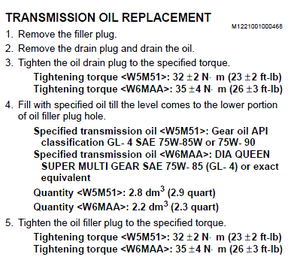

Would you like me to check the capacities in the factory service manuals? I have the 04, 05 and 06 manuals.

This is from the 06 IX factory service manual. If you want em to check the others, I can, just ask.

That's pretty definite. Check 2005 though just to be sure if you don't mind. Should put it to rest.
