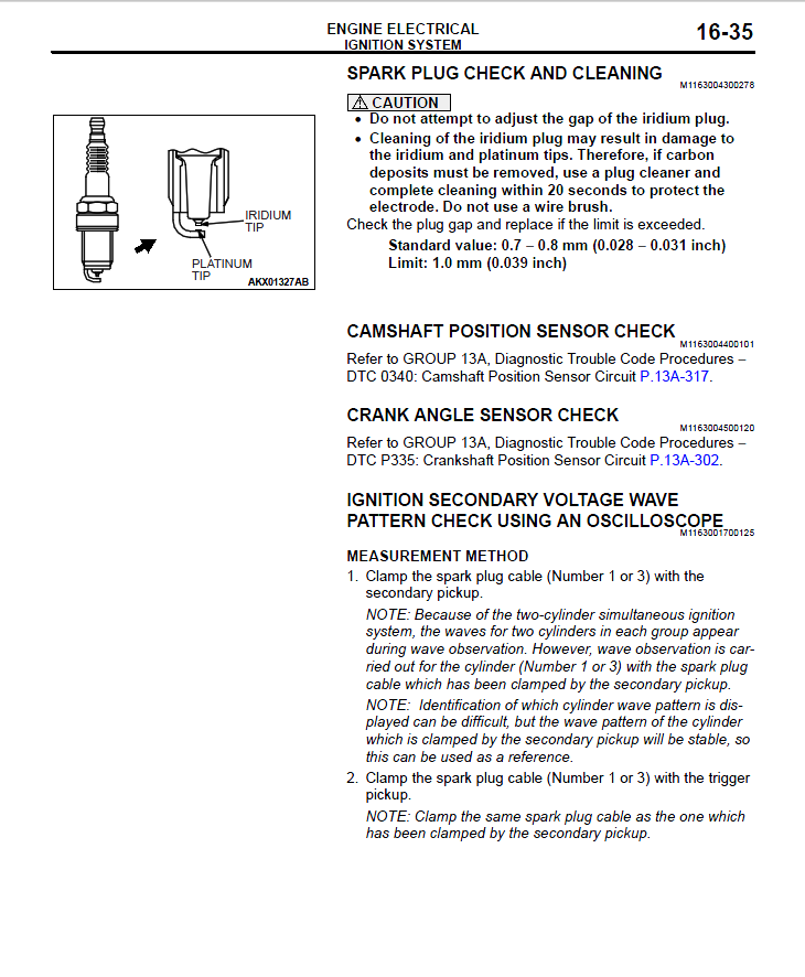

Originally Posted by FrancescoRS
Thanks i know i could look it up but this seems to be faster, what should the plugs be gapped to?
Most people gap between .020-.026, depending on setup.
Here is what the manual says.
Old Oct 28, 2010 | 08:01 PM
Boosted Tuning's Avatar
Joined: Jun 2005
Posts: 2,383
Likes: 8
From: Chico, CA (Nor-Cal)
Originally Posted by evo8426
what are you smoking, crack?
that is the worst advice, that is no where near where any evo should be gapped
OP, tighten all of your ic pipes and check for leaks, pull your spark plugs and inspect them and check the gap and replace if necessary. then get your car tuned otherwise you wasted your money buying parts that just make your car loud and just as fast as a stock evo
He said "mm", ie millimeter, not inches.
.54mm is .021 inches.
