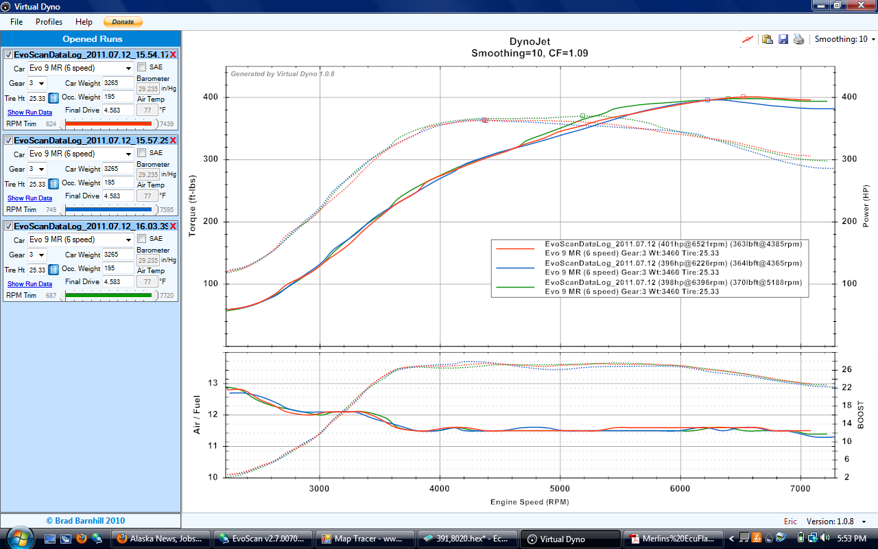

I'll just leave this here......
RRE cat back exhaust $900, BR o2 housing $200, BR downpipe (used) $50, intake $150, electronic boost controller $100, meth injection (HFS-6) $900, tune $0 ..... made 330ish without meth. fuel type is 90 octane.
Total cost of mods $2300
Could have probably been done with less if you bought a cheaper meth kit or cat-back exhaust.
