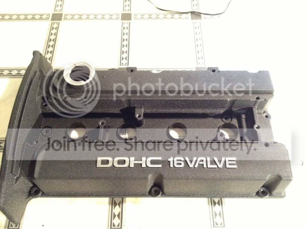

kada__85 It was a DIY job. I used wrinkle black paint, which I baked on at about 200 degrees. I did NOT use my wife's kitchen oven for this. That would have been disasterous for my sexual activity. However, the high temp curing process did the job and all I had to do was to polish up the lettering.
I also NEVER use the dishwasher to clean engine parts. Again if I was ever found out to be doing this my sexual activity would be reduced to popular websites and kleenex...
