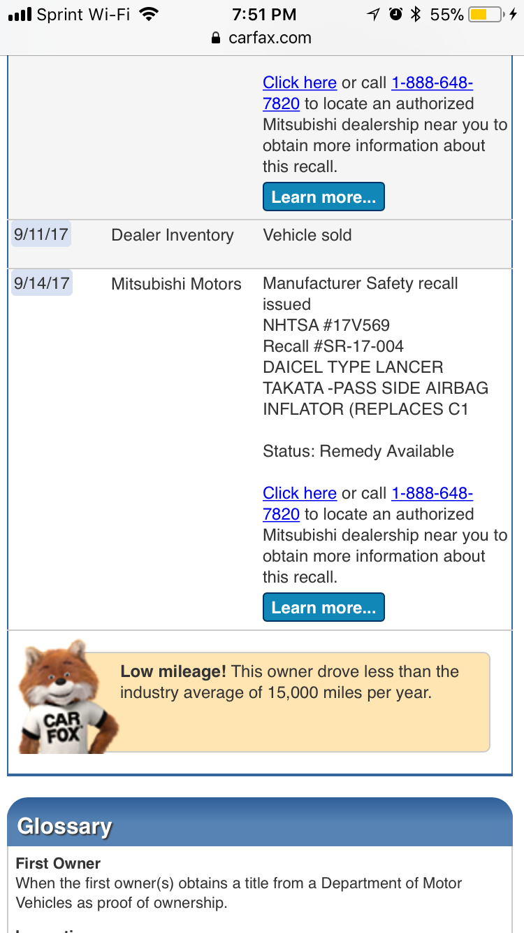

im sure a lot of you watch czero on YouTube so a lot of my knowledge stems from his video on what to look for when buying a “stock” evo. Yes Ik he said not to buy from a dealership but this seems like a pretty fair deal. I also have pics of the carfax I’ll add in here. I bought the carfax, the dealer didn’t provide them.

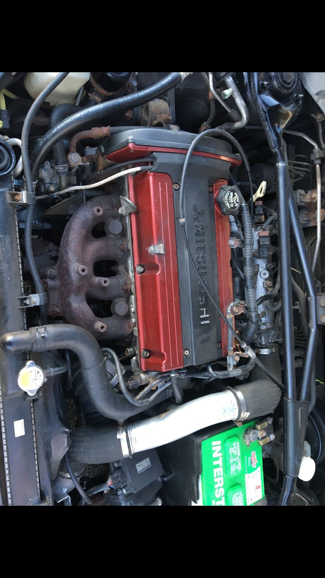

Just got the pic of the engine bay, only one I got!

Ok that helps
Wonder if the 60K service was done ?? (Timing belt etc). Stock heat shield is missing from the manifold.
Stock intercooler piping in place. Couldnt see the air box, if that was stock?
This EvO had the engine xmbr recall due to its location (NY) & the air bag recall was done. Some of us have not done that yet (including me)
You can tell the car was driven all season w/corrosion on the AC lines & other parts of the engine. An under carriage inspection needs to be done, checking for rust / corrosion damage

yeah I’m gonna try to negotiate with the guy if the motor and trans checks out to be okay. I’m not sure if the timing belt and pump were replaced yet, that’s one of the things I’m most curious about too. If it needed to be replaced do you think they’d replace it before I buy it? Isn’t there a warranty they follow? And the car had an undercoat applied at 109k and it looks like it was done at another dealer too. Should I be worried about that? I was planning on getting the car up on a lift when I go to check it out on Saturday to get a look for any rust or loose/corroded bolts

Yeah, these snow belt cars need to be looked at!!
Its good to see this car was active w/the dealer & some level of maintenance appears to have been followed.
Make sure you see no corrosion perforations in the suspension attachment points. Good to see undercoating was done (that helps)
The timing belt is a must to replace and 60K is the time required in the service manual (as you know the water pump must go as well).

yeah so I checked out the car earlier today and i ended up walking away from it. The amount of the rust the car had was unbelievable. There was rust on the inside of the driver side door, rust by the strut towers and the vins numbers on some of the body panels didn’t all match up. The rust wasn’t even just surface rust, it was rot/corrosion. I walked away from the car and didn’t bother to compression test it or anything for that reason.

I was gonna say that looked like some serious corrosion.
Good call.
