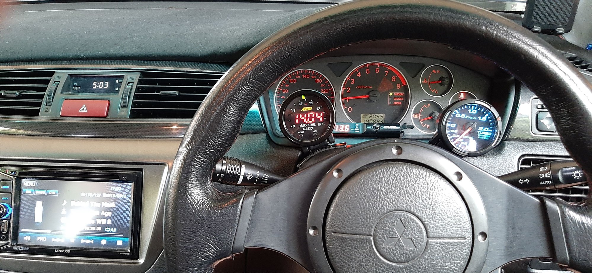

Done installing the AEM AF and Defi boost gauges.

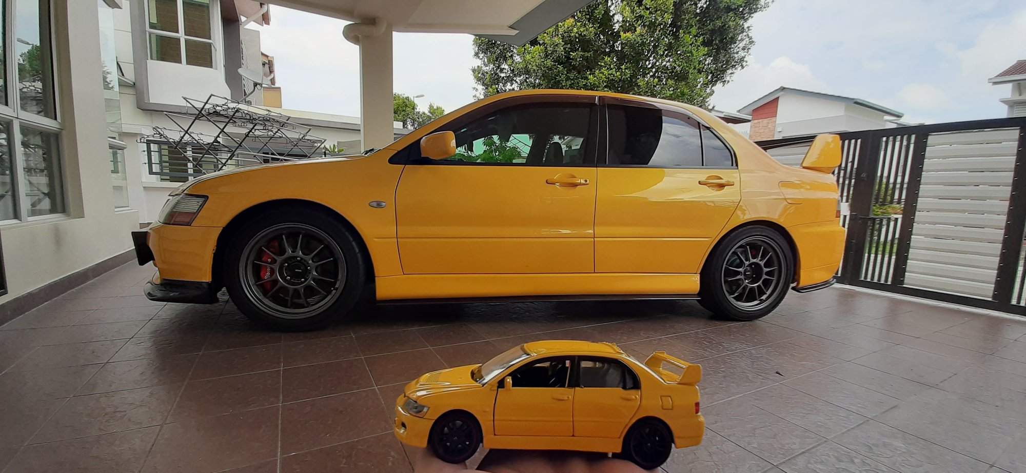

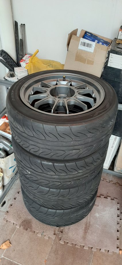

Got Konig Hypergram 17x9 et35 with AD08R size 235/45/17
Wheels installed and got me a die cast size 1:32!

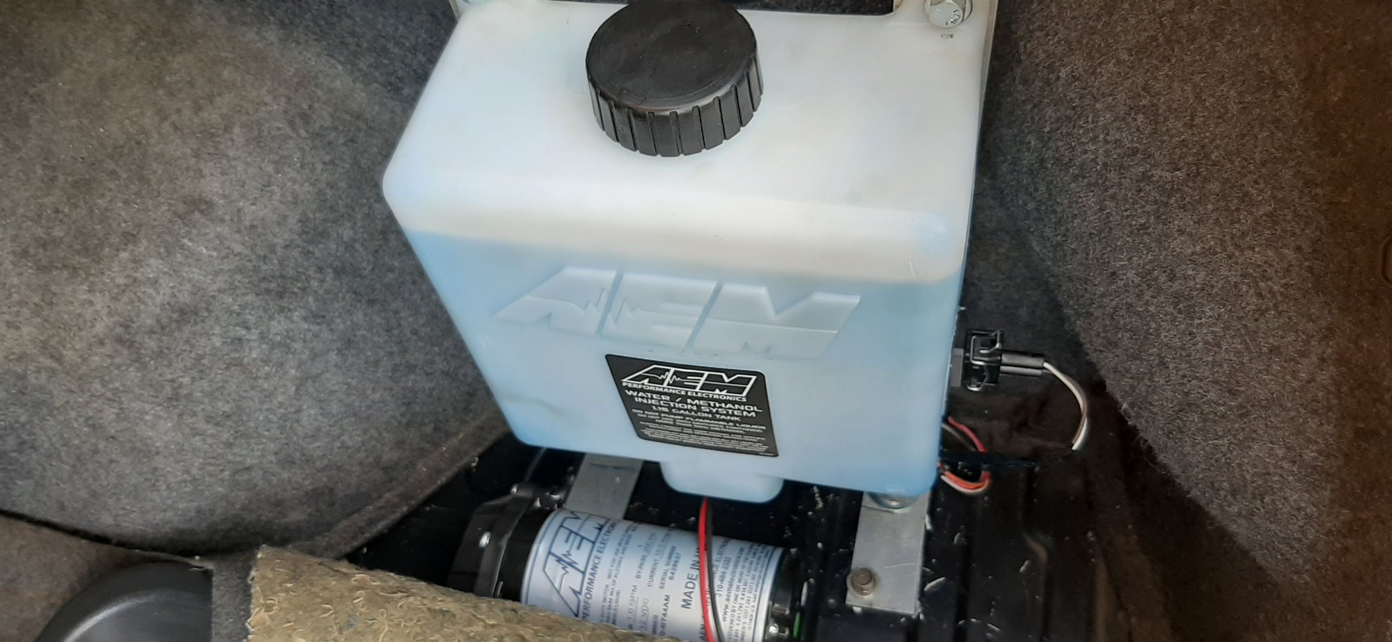

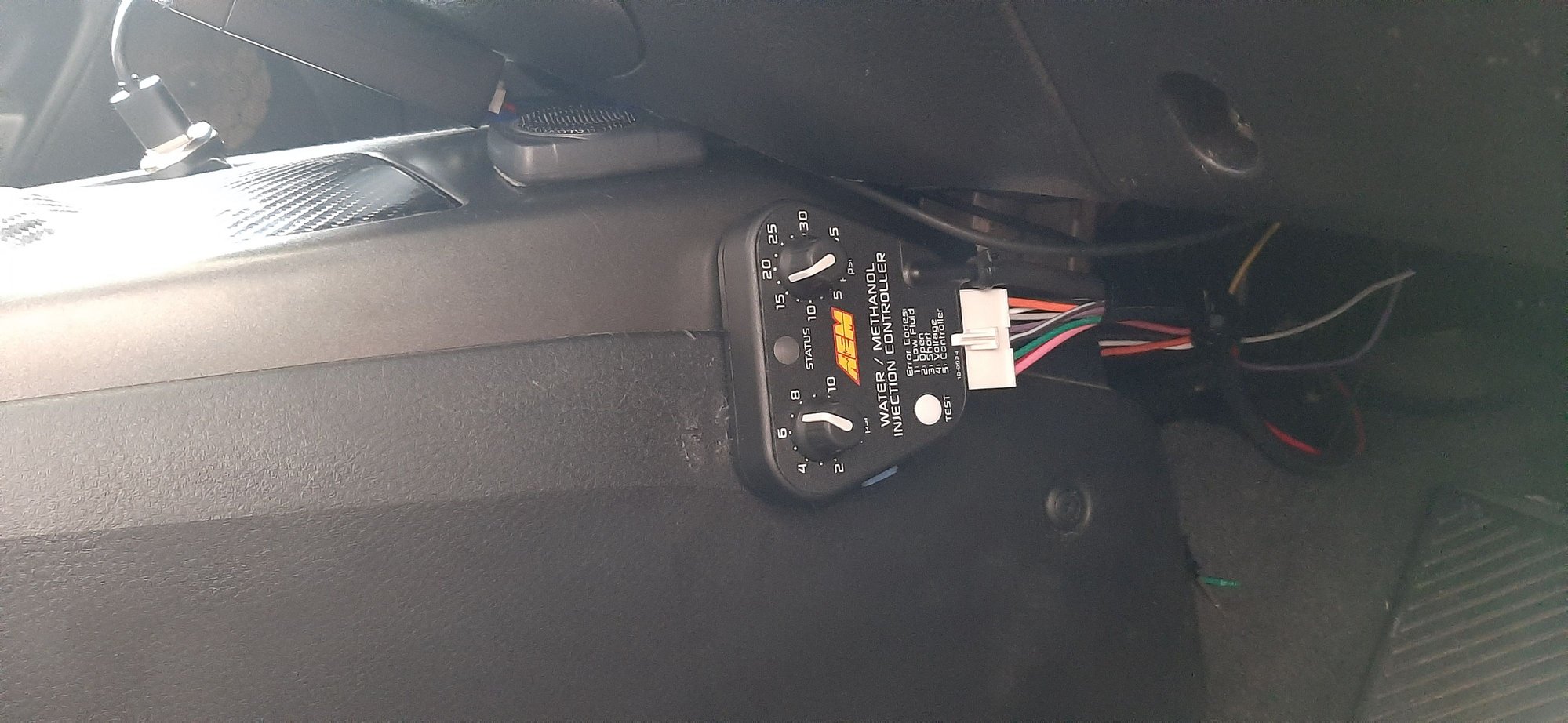

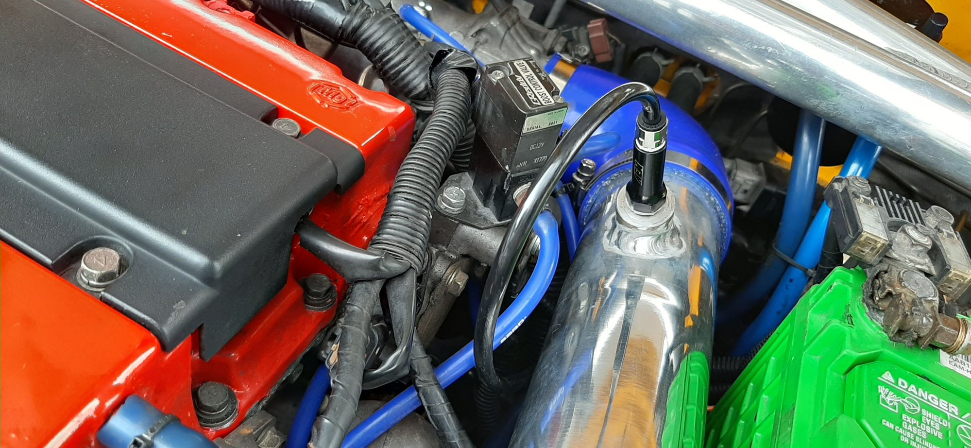

Install AEM water meth kit
Just use 33% meth
Meth injector installed on the intake.

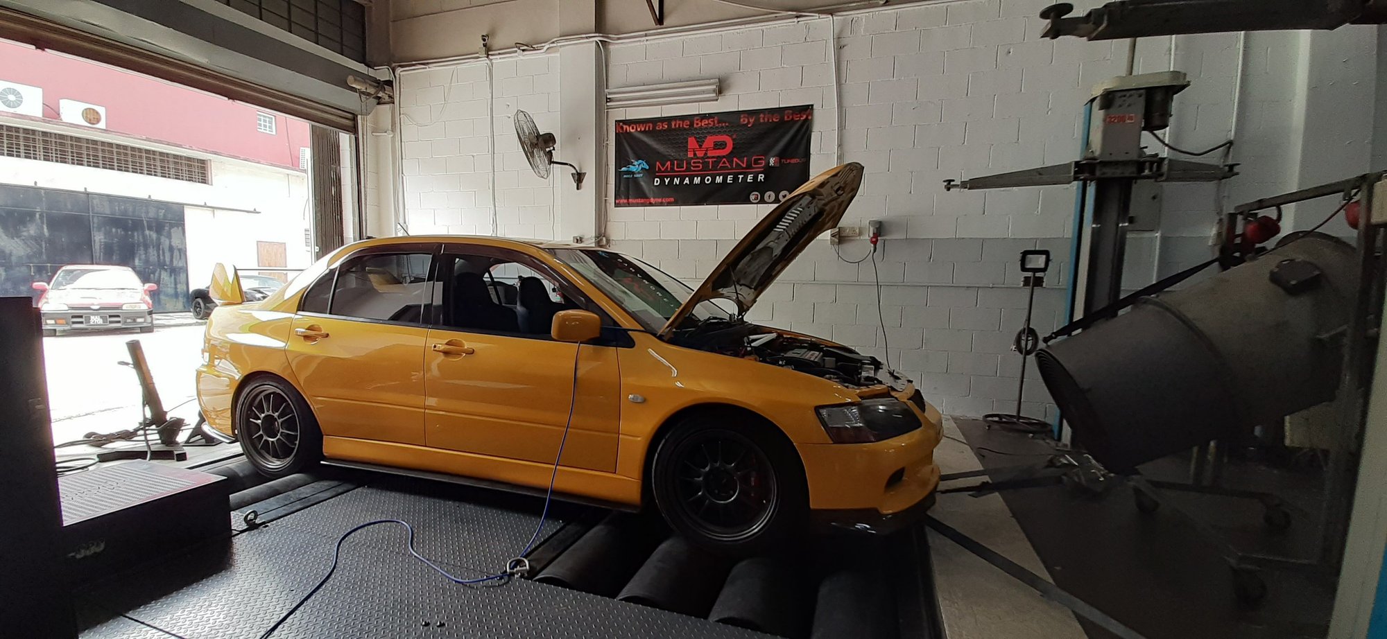

Went for a dyno tune using Mustang dyno. Got 376wHP/410wNM (est.478 HP/530NM on crank) @ 20psi, running on RON 97 fuel plus 33% water meth injection. Meth injection starts at 8psi.

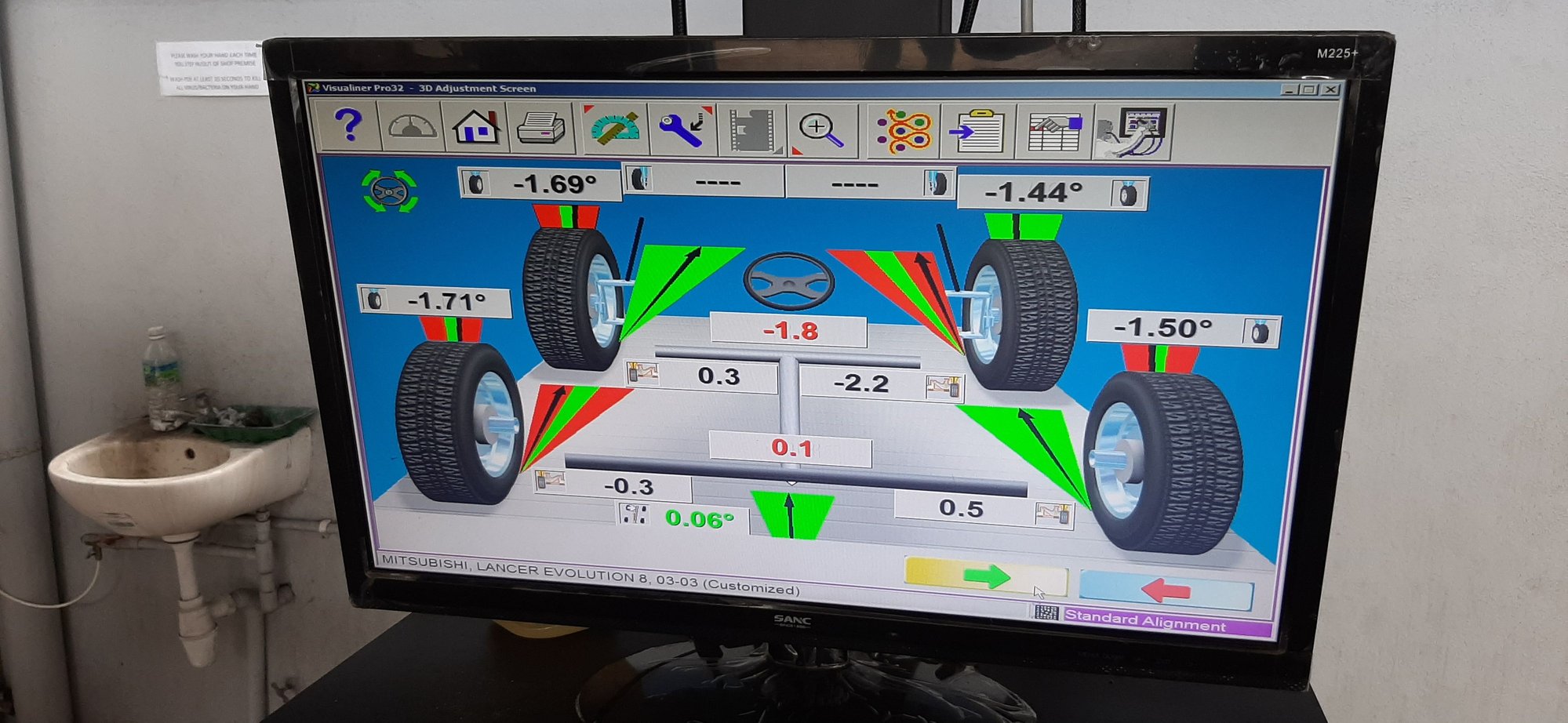

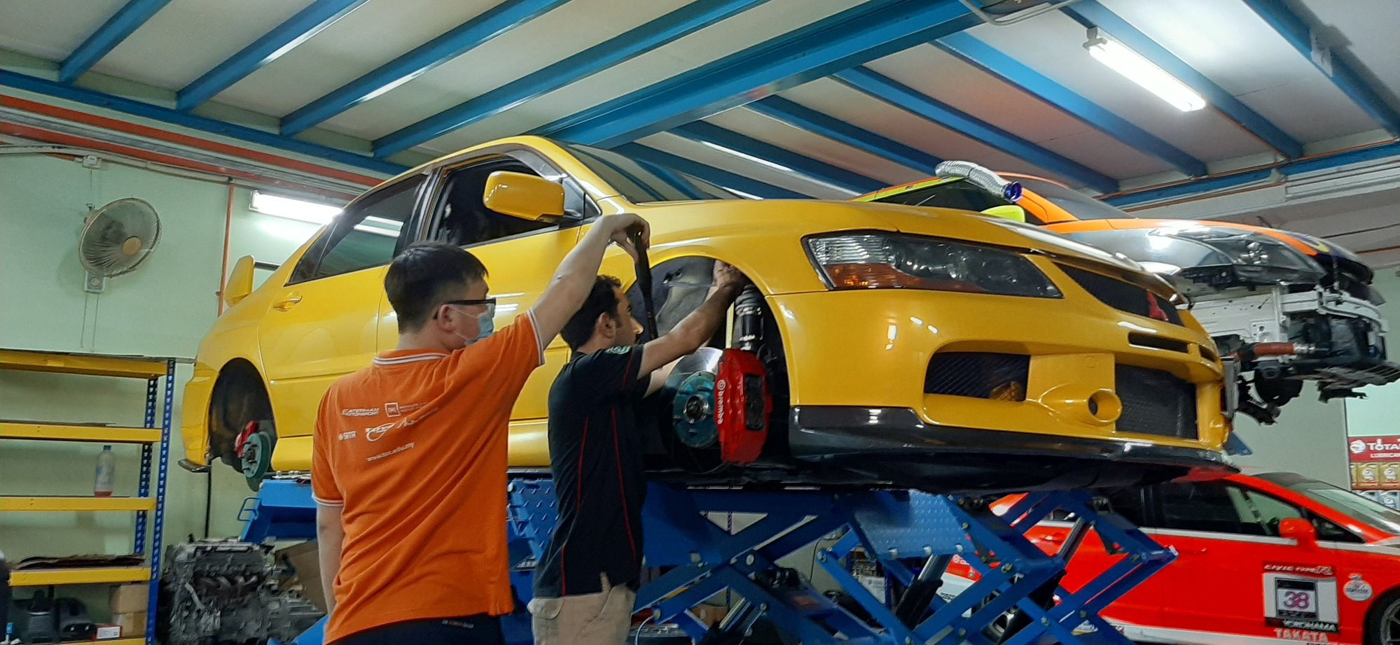

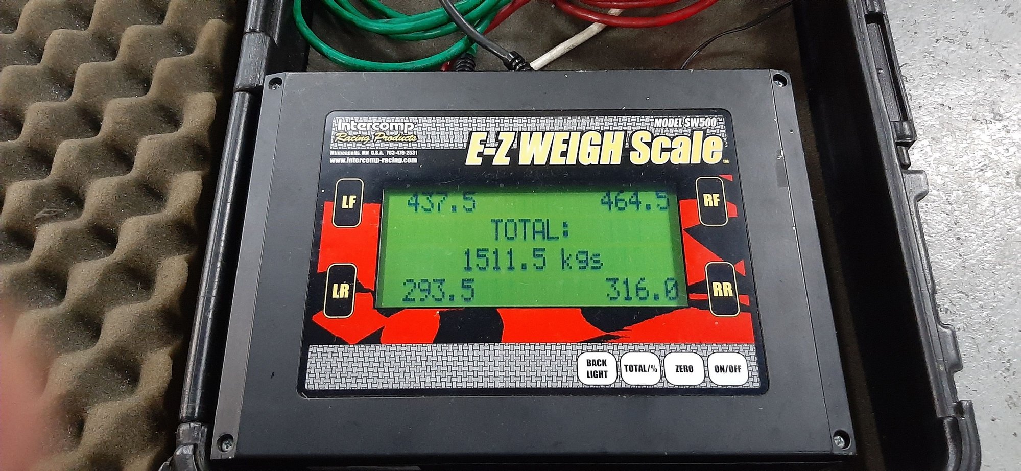

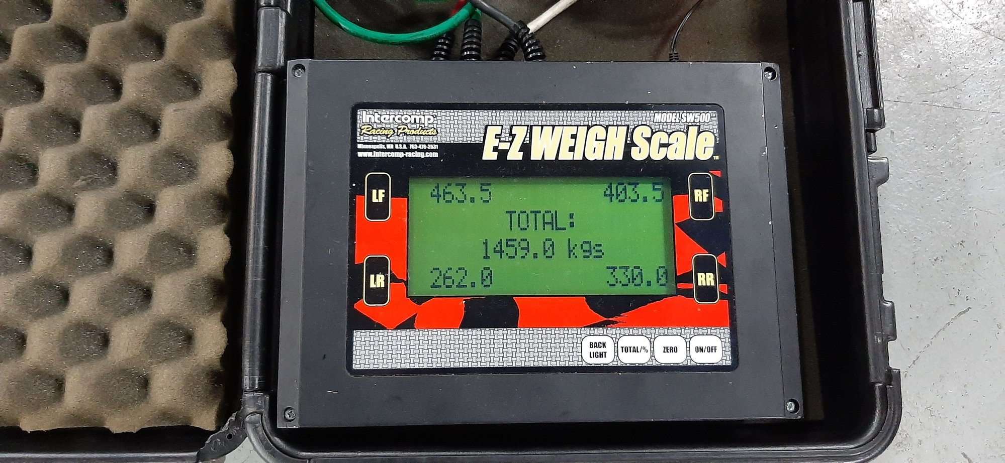

Suspension setup
Just did corner weighing, highly recommended for those using coil overs.
Careful adjustments on the coil overs.
Before, all corner weights were out of balance.
Now much mire balanced. Cross weighing previously 46%, now 50%.

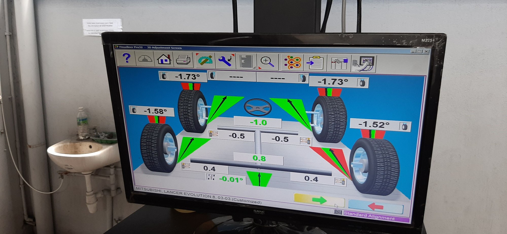

Alignment all out as well.
Now much better.
