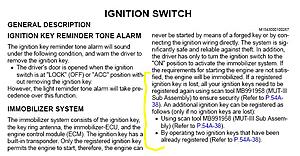

This says you can't do it...

After looking closer in the shop manaul it should be like a 10-20 minute process to program another key...this shouldn't cost too much to do, when you go the dealer it is in section 54A-38.
