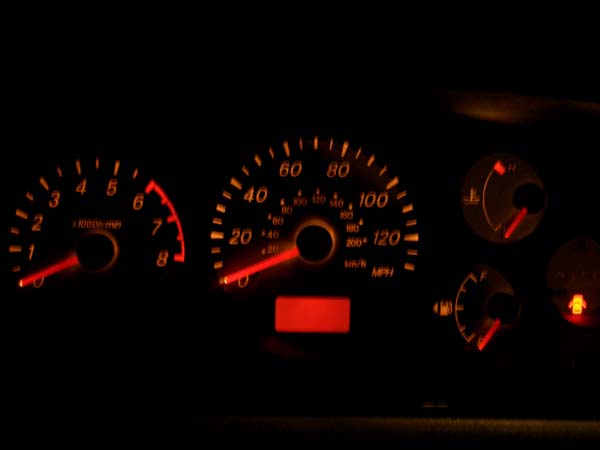

What do you guys think of this ****?

that looks pretty slick, not from a USlancer tho based on the km/hr

Yep it is an OZ!!!!! I thinks hes in canada though.
