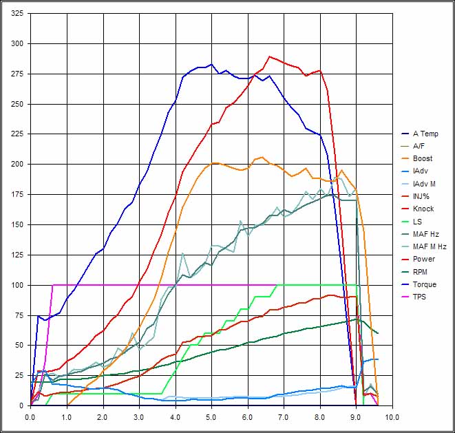

Okay, here's a graphical representation of your log data.. Plus a HP/TQ graph overlayed onto it, take the HP numbers with a grain of salt, I made assumptions about weight, driveline loss, no SAE temp correction, and wheel diameter (basically all stock numbers)
But it should offer you some insight into whats going on.. It looks like in some areas, the ECU wants to run a bit more timing, and others its not quite as much, so it appears you can get a bit more timing out of it. The MAF reading (input) is pretty stable except for that "Clipping" at the end of the run where you had 1700 repeat 3 times) Your boost curve for closed loop can use a little work to smooth it out a bit, which will help things (especially the torque/hp dip you see around that point) Your at 91% in some areas on your injectors, given how rich you need to run the car for the 91octane gas, your close to needing to upgrade your injectors.

I'll have to think about your options a little bit.. If you can get the boost levels a bit more stable (maybe adjust the closed loop boost gain so its a bit more responsive) you will pick up the torque where the boost dips..
The clipping, well, honestly the only time I've seen that is when using electronic means of preventing fuel/boost cut (Fuel Cut Defensor) it may just be anomolous and coincidental so the future runs just keep an eye open for it.
Reducing your cam overlap with the other timing will boost your midrange torque a bit and should keep your HP powerband around the same, though the power might fall off a bit sooner, but you can gain some of that back by fiddling with the midrange timing after your peak boost where the ECU appears to want to run a little more timing than your actually running on the UTEC, but don't alter the timing maps until you can see if you can get your boost curve to look a bit more smooth so your not working against yourself.
If you can look at your EGT's, since your cam overlap, timing, and AFR's will have an impact on the temps (Driving them higher) which can be a bigger headache than running a little lean..

Originally Posted by Widebandphillip
Oh man, that means your still on stock injectors? I've had to add fuel all over the board. Try adding about 10 to the entire map. I really doubt your afr is in check. Usually i see stock injector duty cycles at around mid 90s-high 90's if you tune for a 11.3-11.5 afr near redline. So i guess this tells me you're running pretty lean. No where in my map did it have negative values.
When My boost was around 19psi, I'd be around 10.5afr at 90% duty, so Its certainly likely he's ok, but if he doesnt actually have a wideband at this point I'd hold off doing anything else..
I am using Innovate LM1 and it was just calibrated right before I started tuning for the camshafts. So I think I am safe on that department.
Mmmm... I've already changed the timing gear to -4/-1 and the car idles so much better. I will see how it goes and I might consider change it back if I lose too much bottom end. I did a couple more 3rd gear WOT runs but I had some noise at above 6000 rpm according to my logs, so I will retard a bit more timing up top and try to advance some in the midrange to make up for the lost torque below 4500 RPM. But overall, I feel a little lost in torque under 4500RPM, and I gain some top end power (when there is no knock events). I don't have an EGT gauge, so I do worry about damaging my engine from the extreme heat it may create. So you suggest me to stay with -3/-3? Does it mean -4/-2 will create less heat than -4/-1?
I changed my boost gain from 50 (from the in my previous post) to 48 (the log below), the boost seems to ramp up a little faster, but it is still not very stable. Should I crank up the boost gain until I see some spike? Will it help stabalize my boost and making it more repeatable? My boost vary about 1psi form run to run.
Here is one of the logs I had after changing -4/-1 after some quick tweak to fuel map:
DATA1
, , , ,Load,Knock, , , Mod, Mod, , Mod, WB
RPM, MAP, MAF,TPS,Site,Count, Ign#1, Inj#1, Ign, Fuel,Boost, MAF, AFR
, psia, Hz, % , , , deg , duty , deg, % ,(CL) , Hz,
2142,-10.3, 50, 7, 00, 00, +31.2, 2.7,ECU. , +0.0,ECU. , 73, 00.00
2108,-10.3, 115, 15, 00, 00, +33.4, 5.8,ECU. , +0.0,ECU. , 123, 00.00
2101, -9.4, 121, 15, 00, 00, +32.3, 5.7,ECU. , +0.0,ECU. , 120, 00.00
2171, -7.8, 192, 20, 00, 00, +30.1, 7.7,ECU. , +0.0,ECU. , 266, 00.00
2181, -5.0, 257, 71, 10, 00, +15.9, 11.7,ECU. , +4.3,ECU. , 291, 00.00
2211, -2.6, 271,100, 10, 00, +16.0, 11.7,ECU. , +0.9,ECU. , 285, 00.00
2258, -0.7, 284,100, 10, 00, +14.9, 12.9,ECU. , +4.5,ECU. , 323, 00.00
2384, +0.9, 303,100, 10, 00, +13.9, 13.2,ECU. , +2.1,ECU. , 308, 00.00
2465, +1.8, 325,100, 10, 00, +13.8, 13.9,ECU. , +1.7,ECU. , 387, 00.00
2495, +2.2, 346,100, 10, 00, +13.9, 14.4,ECU. , +0.6,ECU. , 322, 00.00
2564, +2.9, 369,100, 10, 00, +14.3, 15.8,ECU. , +0.8,ECU. , 330, 00.00
2649, +3.6, 401,100, 10, 00, +13.2, 17.6,ECU. , +0.9,ECU. , 434, 00.00
2732, +4.3, 424,100, 10, 00, +12.3, 19.1,ECU. , +1.7,470.00, 387, 00.00
2858, +4.9, 477,100, 10, 00, +10.1, 21.1,ECU. , +1.3,470.00, 563, 00.00
2893, +5.8, 488,100, 10, 00, +8.0, 23.0,ECU. , +1.6,470.00, 459, 00.00
2994, +6.5, 548,100, 10, 00, +7.3, 25.7,ECU. , +1.8,450.00, 541, 00.00
3103, +7.7, 677,100, 10, 00, +6.2, 28.8,ECU. , +1.7,450.00, 883, 00.00
3274, +8.8, 736,100, 10, 00, +5.3, 32.2,ECU. , +1.4,435.00, 712, 00.00
3387,+10.4, 813,100, 10, 00, +4.2, 35.6,ECU. , +1.6,435.00, 710, 00.00
3508,+12.4, 902,100, 20, 00, +4.3, 38.3, +7.4, -3.3,435.00, 892, 00.00
3671,+14.0,1008,100, 30, 00, +4.3, 51.1, +7.5, +0.4,455.00,1131, 00.00
3770,+16.3,1061,100, 40, 00, +3.3, 53.9, +7.2, -0.5,455.00,1315, 00.00
3903,+17.9,1121,100, 50, 00, +4.4, 53.3, +6.7, -1.3,455.00,1250, 00.00
4074,+19.0,1210,100, 50, 00, +4.0, 55.4, +6.9, -1.1,460.00,1213, 00.00
4240,+19.9,1228,100, 60, 00, +4.3, 55.5, +6.8, -2.9,462.00,1141, 00.00
4391,+20.1,1216,100, 60, 00, +4.3, 56.3, +6.8, -2.9,462.00,1168, 00.00
4655,+21.1,1275,100, 60, 00, +4.5, 61.5, +6.9, -3.0,463.00,1428, 00.00
4803,+21.1,1302,100, 70, 00, +6.7, 62.9, +6.7, -4.2,465.00,1308, 00.00
4894,+21.7,1400,100, 70, 10, +3.8, 66.1, -1.2, -4.7,465.00,1428, 00.00
5035,+21.5,1428,100, 80, 00, +4.4, 65.8, -1.4, -4.0,465.00,1373, 00.00
5159,+21.3,1488,100, 90, 00, +3.8, 68.2, -1.6, -3.6,465.00,1366, 00.00
5282,+21.7,1445,100, 90, 00, +3.7, 68.5, +6.8, -4.6,465.00,1453, 00.00
5376,+21.1,1479,100, 90, 00, +3.7, 71.3, +6.8, -3.0,465.00,1436, 00.00
5592,+20.8,1543,100, 90, 00, +3.6, 73.3, +6.8, -2.5,465.00,1515, 00.00
5621,+19.9,1567,100,100, 00, +3.6, 76.4, +7.5, -1.1,465.00,1524, 00.00
5767,+19.0,1572,100,100, 00, +6.0, 76.7, +8.6, +0.5,465.00,1644, 00.00
5995,+18.8,1612,100,100, 00, +6.6, 79.2, +9.1, +1.6,475.00,1677, 00.00
6127,+18.1,1644,100,100, 00, +7.0, 82.6, +9.6, +1.6,475.00,1700, 00.00
6265,+18.1,1677,100,100, 00, +8.3, 82.9,+10.2, +2.2,480.00,1785, 00.00
6397,+18.6,1724,100,100, 00, +8.4, 86.0,+11.0, +1.5,480.00,1773, 00.00
6410,+18.6,1779,100,100, 01, +8.1, 87.3,+11.5, +3.9,485.00,1798, 00.00
6653,+19.5,1824,100,100, 00, +8.9, 91.0,+12.1, +2.8,485.00,1908, 00.00
6666,+20.8,1824,100,100, 00, +9.4, 89.6,+12.8, +3.7,487.50,1879, 00.00
6761,+20.8,1805,100,100, 05, +7.3, 92.7, +9.5, +4.1,487.50,1893, 00.00
6872,+21.1,1798,100,100, 00, +8.4, 91.9,+10.9, +3.7,490.00,1865, 00.00
6747,+20.4, 385, 21, 00, 00, +29.4, 19.7,ECU. , +0.0,ECU. , 129, 00.00
6301,+12.0, 101, 10, 00, 00, +37.9, 7.9,ECU. , +0.0,ECU. , 168, 00.00
