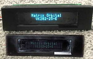

This is a project I started developing with the blessing of Tom (ECUPlus guru) which will be a plug-in display addon
This is a prototype based on a matrix orbital display, and basic stamp project board. I think I will upgrade to a 4 line display but so far its an interesting project.
I'm working out some packaging ideas and some other ideas, but I wanted to generate a little interest in the project.
The size of the unit is about the size of a CDRom drive faceplate.. the depth of the display is about an inch (probably less with the newer displays I found)
Plans for the device is a display/logger that writes to an SD Card and you can retrieve your logs later..

Basically it'll be a little project box that you can hook up a display to or just do logging.. Something SORELY lacking anywhere in the Evo products is an easy way to log data and view operating parameters without having a PC hooked up..

That's looking pretty good. I am interested. What kind of information would be displayed?

MalibuJack: Could somehow make use of the display box that came with the Zeitronix WB?
As for the display output you could probably send anything from ECU+. i.e. :Timing, fuel trim, knock voltage, or any of the 0-5V auxillary input that can be read by the box. Sound about right?

Yep, It will log everything, and the display "should" be configurable or at least scrollable. The display box if you know who manifactures it, I can fit a matrix orbital or similar display into it.. But I want to get something working first.

I think I'm going to use a module compatible with SD cards.. CF is possible but SD is alot smaller.

thats the plan, actually the plan was to make it about 1/2 din with a smaller display. Originally I wanted to place the display in the opening for the clock but I found some better VFD and OLED serial graphic displays that I"m researching at the moment.
The hard part is finding the hardware to do the function of logging and driving the display. At the moment the demo will be running as software on an old laptop but only until I can find hardware to do what I want.

I wrote a simple application that used serial ports on my PC for the time being to get the code and features roughed out.. And in the process I found something interesting about FTDI Serial devices and how they work together.. I definitely got caught up in that and resolving some other issues so this got delayed.
HOWEVER, my Basic stamp development kit showed up, I have to create a few quick circuits to do serial communications since its only equipped with one. I also am waiting for a hardware chip based reader/writer since I have a flash chip, and know how to program that, There is something that does something similar for SD cards, so I'm trying to get more info.
