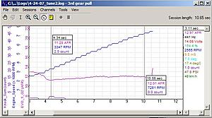

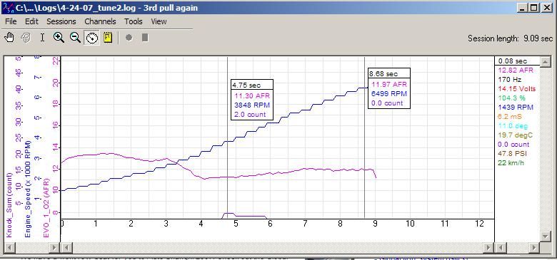

Alright Gurus,
I have been doing extensive amounts of logging and trying to do some tweaking, but I have two questions that have me stumped.
First - My setup
04 Evo
Megan Racing O2 Housing, DP and Cat back
Perrin HFC
Blitz EBC dialed in at 22.5 psi
Questions:
1) looking at the logs below that I took this am I still have knock and its occuring the same places as it has been and based on the rpm and load I have dialed down timing several times and its not going away. How do you tell the difference between real knock and false signals? this could be my exhaust rattling or something?
2) I have dialed my AFRs back in my high octane map a few times and am now at the limit and my AFRs are still around 12 (11.5 - 12.5). Am I doing this right and just am in dier need of less boost or a fuel pump or am I doing this wrong?
Attached Thumbnails Trying to tune - 2 questions-pull1.jpg   Trying to tune - 2 questions-pull2.jpg   Trying to tune - 2 questions-fuelmap.jpg

I could be wrong so dont trust me saying this, but it is something to try.
IIRC starting your pull from a very low RPM, ie. 1.5~2K, it can cause false knock. Try a 4th or 5th gear pull from 3K to 5K and see if the knock is still there

I wouldn't be concerned with a 2 count of knock during spool up, I'd be more concerned about the 12.0 AFR and having to throw tons of fuel at it just to get that. Did you get the fuel pump installed yet?
