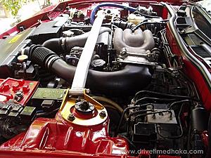

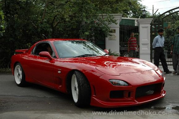

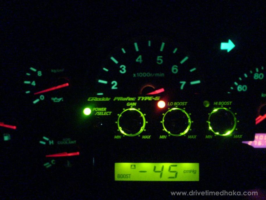

First off, I don't own an EVO, I drive a 1998 Rx7 Type R. (pictures attached).

welcome sick rx i wish i had one like that.
