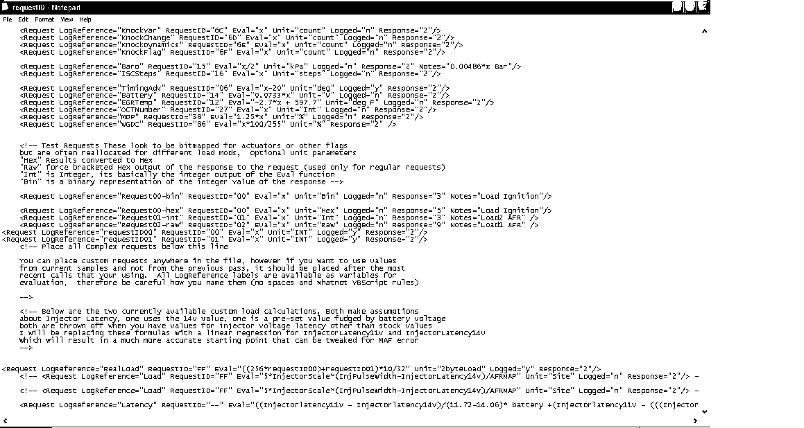

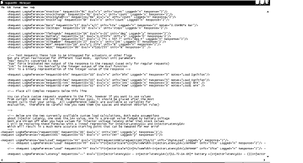

Ok i did two print screens. They are labeled the way i have it, and the way u suggested. What do u think?
Attached Thumbnails Trying to get 2byte load to work with mitsulogger-way-u-suggest.bmp   Trying to get 2byte load to work with mitsulogger-way-i-have-.bmp
Old Feb 14, 2008 | 01:57 PM
burgers22's Avatar
Joined: Jan 2006
Posts: 953
From: Oxfordshire
The one that says, the way u suggest, looks very much like the way I have it !
So you could try it as I suggest, it seems to work for me.
MB
